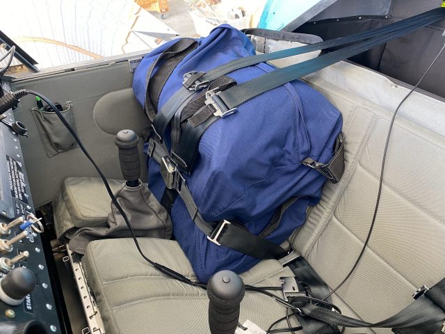

What have folks used for ballast during Phase 1 flight testing to explore and prove the flight envelope? I need to perform some max gross weight testing as well as aft CG testing and am trying to figure out a safe/secure way to add weight to the plane.

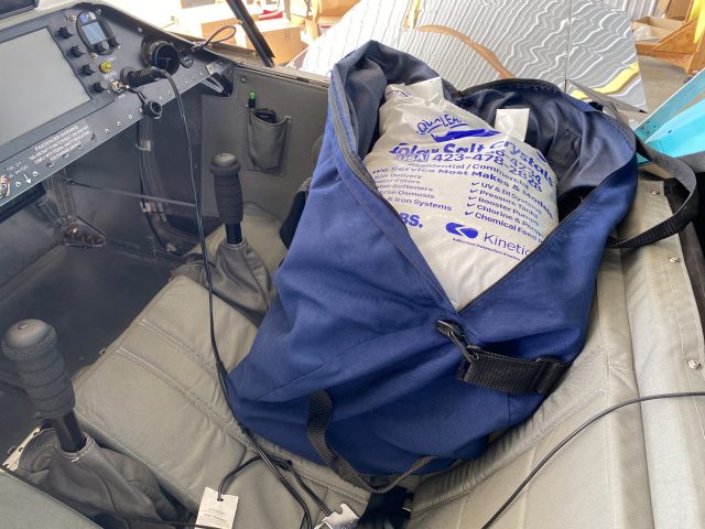

Re: Flight Testing Ballast?
Posted: Sun Jun 14, 2020 3:38 pm
by Rynoth
Thanks for the tips! As it happened, I had several 40-lb bags of water softener salt in my basement. They did the trick!
They stayed in place very well, and actually kind of made the cockpit more comfortable. Nice to have the armrest. No issues with full control deflection.
