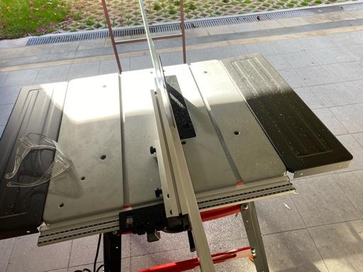

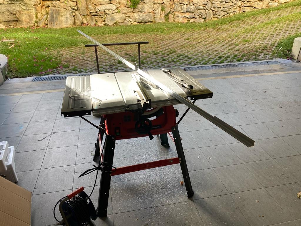

Having failed to make those cuts in my own band saw, I decided to bite the bullet and bought a table saw, changed the cutting disc from wood (less and spaced teeth) to a multi material disc (more teeth), and just tried to cut that loooong angle.
It seems it will do the job.
Thanks again for your help

And these XENOS longerons are nothing less than 11 ft long…
It is quite a job

I cut my longerons with a table saw with a carbide nonferrous metal cutting blade. I used a candle for the wax to lube the blade and longeron. I made a fence to keep it straight. I drilled holes in the corners where the cut would stop. This worked out fine. I just went slow and kept both hands on the longeron to keep it against the fence. Also, I set the fence so the gap was slightly greater than the exact dimension. I figured a file and scotchbrite wheel would take in down. It did.

One thing to watch out for cutting aluminum on a table saw. I have a central dust collector connected to mine. Aluminum chips get hot. Guess what happens. Been there, done that.

It worked!!
Here is the first Longeron (upper right) for my Xenos B
Cheers
Carlos
