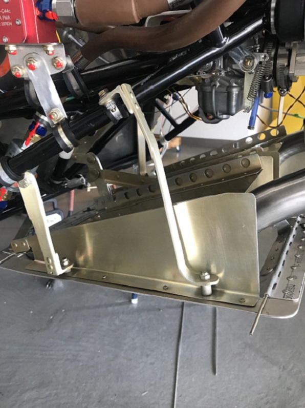

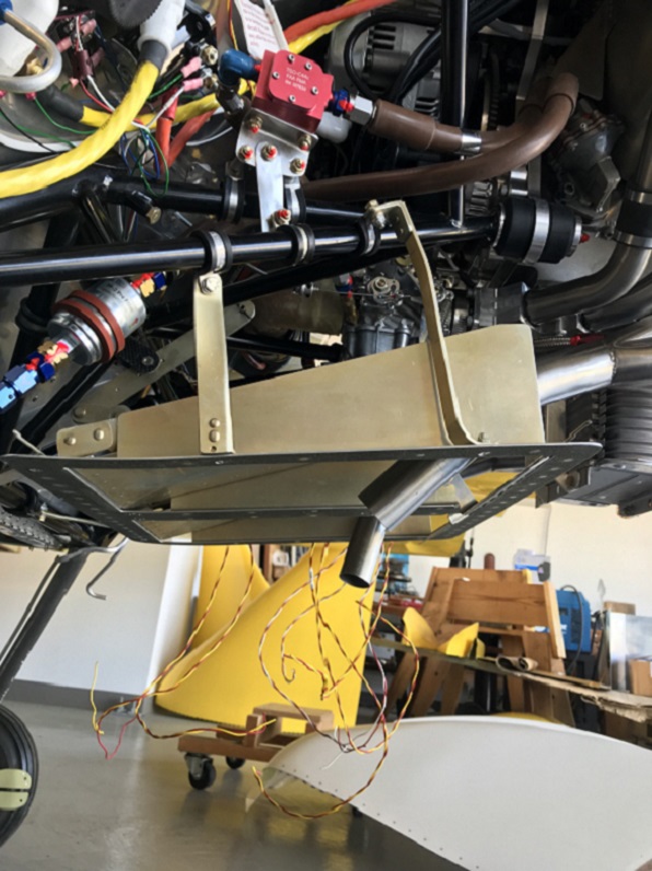

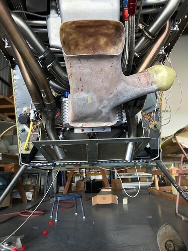

Well, if you want to spend a week making an adjustable cowl flap, then your problem disappears. Mine was modeled 3D in Inventor and all fit except I didn’t account for the slant of the firewall. I had to redesign the mounting for the actuating lever. The cowl flap gives a 12% improvement in L/D with it closed vs. open. I’m sure the much faster Waiex could have some exit area closed during cruise to reduce drag.
I can share pictures but there are some already posted to this forum and on my EAA Builders Log. But here are a couple to give you an idea.
Cowl Flap Rt Side Mounting Sm.jpg (157.44 KiB) Viewed 1125 times
Cowl Flap Finished Sm.jpg (137.5 KiB) Viewed 1125 times
Cowl Flap Closed Front Sm.jpg (198.95 KiB) Viewed 1125 times
