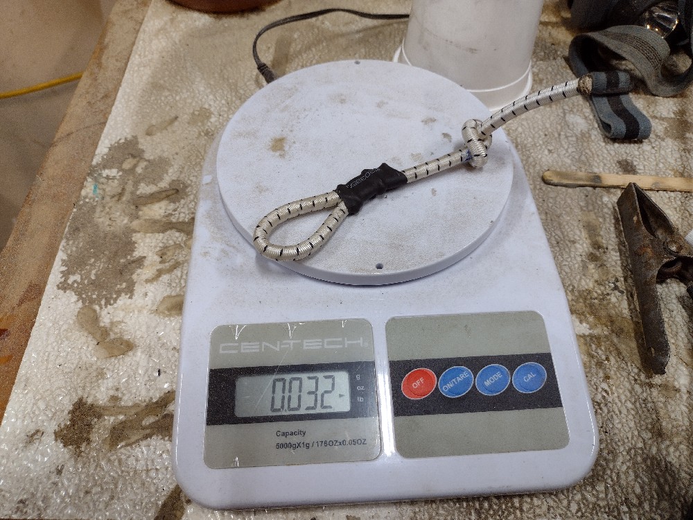

Yachting suppliers sell bungee cord but maybe that’s not such a useful suggestion if you live in Wyoming. I also used a rope cleat intended for a yacht as a way of making the tension easily adjustable.

I bought bungee cord for my sailboats.
https://www.sailrite.com/Shock-Cord-3-16
Many diameters and colors available. They deliver to Wyoming I’m sure.

Ken, I began flying with bungee cord before replacing it with springs which work well for the intended purpose.and seem to require less attention over time.

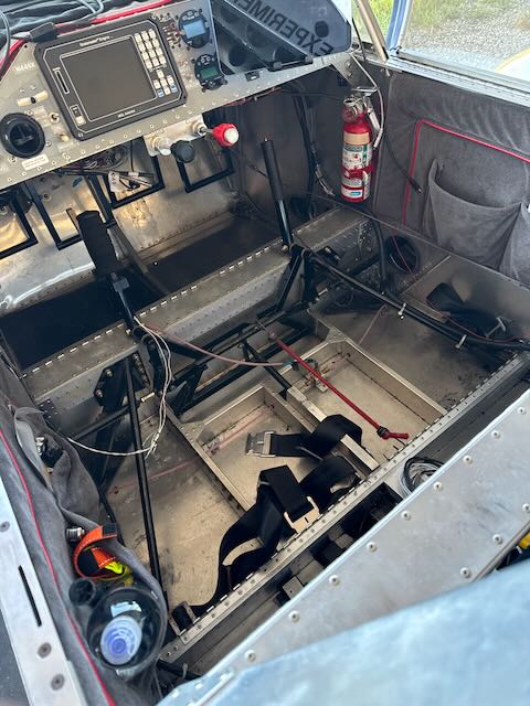

Today I removed the seat and discovered the elevator bungee. After 20 years it doesn’t do much, and I wonder what I should replace it with. Should the cord engage at a neutral position and add just a little back pressure or should it pull the stick all the way back? Or some else entirely?
Are you talking for the Aeroconversions trim system? Sonex sells the springs.
The dial-a-trim manual can be found on this page:
My fixed spring pulls the elevator nose down, and the spring connected to trim pulls it back up.
Nothing so complex. The red thing in this photo.
