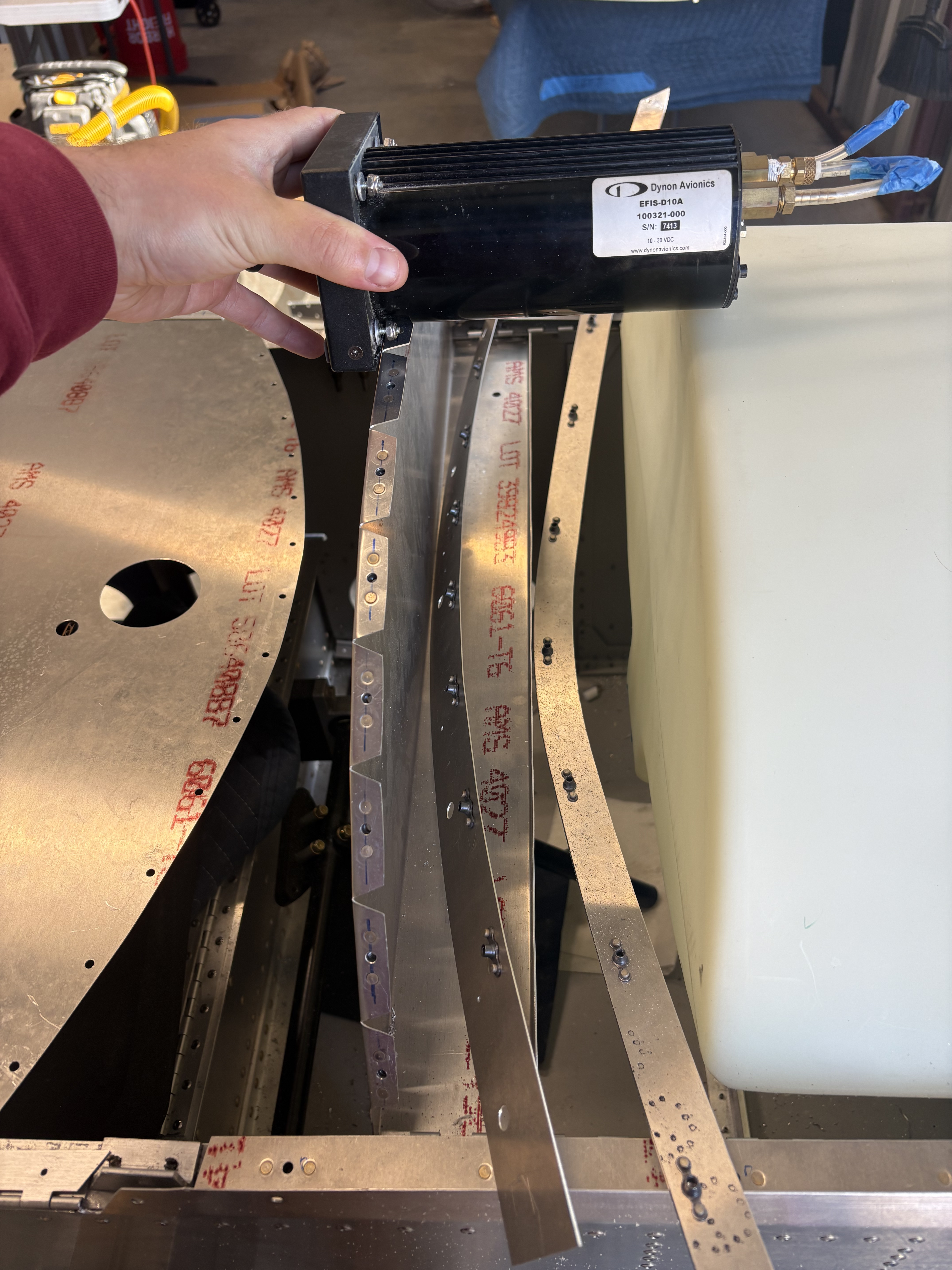

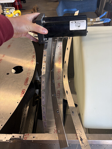

Oof, I wish I would’ve known…
I know this is an old thread, but I wanted to note: the back of the panel to the fuel tank is about 5 in. A D10A is too long to fit.
