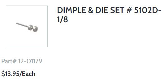

AIRCRAFT SPRUCE DIMPLE TOOL
Thanks for your replies. I dimpled two scraps and the rivet pulled better than expected. See photos. The enlargement was minimal because I hypothesize that the 120 degree angle makes for minimal dimple depth.

I still wonder why the dimpled 1/8 inch hole did not spread out like I expected.
