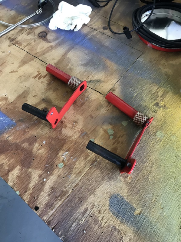

I did my first taxi test which I tested the differential brakes for the first time. I had the FAA visit the other day for my AWC inspection. They wanted to see the brakes stop the plane and for me to taxi it. The AeroConv. brakes didn’t hold very well at all but I did get it to stop and tried a 180 but couldn’t hold one wheel still to break free the tailwheel. I ended up getting out and moving the tail over by hand. But I passed the FAA test. I was going to try another taxi test today but noticed the brake pedals were bent. I bought these pedals as part of a group buy here so I know more of these are out there. Take notice:
The 1/8 x 1 flat bar on the side does not take much force to bent it. I removed mine to repair today and bending it back straight on the vise I could do with one hand with a 1 foot long tube slid over the pedal. It obviously is no match for my chicken legs.

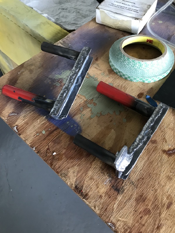

I had a piece of 1" square x 0.065" 4130 tube in the scrap box so I cut that in half to make a reinforcing channel to weld on the side. I haven’t welded in years so a good opportunity to get some practice. Here is the repair so far.

Scott got good advice. They need to be strong. Looks like you have a good set up.
I am surprised at myself for thinking an 1/8 x 1" sheet or bar would take that force of a foot out on the foot pedal tube. I just didn’t think about it since I thought this was a proven design. I told my hangar neighbor after my first taxi and brake application that my cylinders may bleeding because I had a soft pedal. The soft pedal was me bending the brake pedals. Good idea to offset the foot pedal forward. It was awkward trying to press so far with extended toes. I’ll try adding a rubber sleeve before I do more surgery on the pedals.
I noticed I had cracked the rosette weld of the foot tube in the 1/8" side sheet so I fillet welded that on the inside and rosette welded it to my channel reinforcement I added. I also have a nice fillet weld on the flat sheet on the cylinder mount that I hope keeps it in position.
