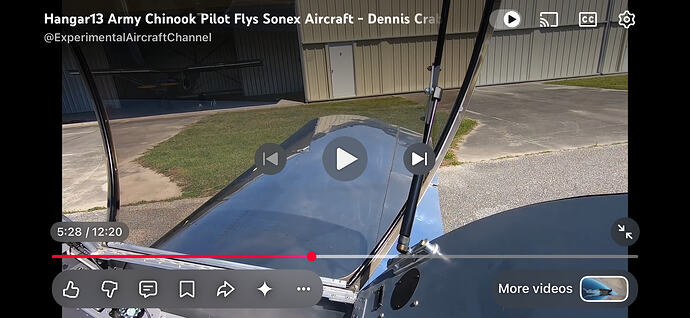

I recently saw this canopy closure for a Sonex. Anyone have details on this cylinder or any experiences with other approaches or methods? I did a quick search of the site but didn’t find anything.

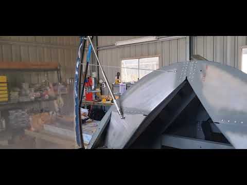

Andy’s Waiex down under has a gas strut. Specs in the comments.
I’ve got the cable, 430 hours and counting.

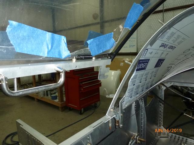

A related topic. Where I live it is hot much of the year. So, like others have done, I made a custom canopy latch that allow the canopy to be left partially open. I added one more twist. I left the locator pin long enough that it engages while in the partially open position. I also added a spring to keep the latch pulled close. That allows me to leave the canopy partially open while parked in the sun and not worry about it blowing fully open. So far so good.
Very nice. Typically we just suffer when it’s hot. Sometimes the left seater will hold it open while the right seater taxis. We loop a bungee through the left air vent and hook onto the non-folding handle, with a roll of masking tape on the sill to keep it open when parked. The single hook keeps the masking tape from departing.
Thanks.

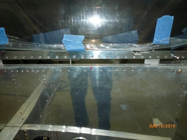

And I forgot one detail. Since I added the spring, I needed something to pull against while I open the canopy. So, I added l little button on the inside and outside to hold while operating the latch. If you look closely, you can see it in this picture.
I’ve got the spring, it was per plans. I could use the button on the outside. How did you implement it?
It’s coming up on seven years ago I honestly don’t remember. It couldn’t have been too hard, I figured it out. All I remember is tubing, a single steal screw, screw head on the outside and elastic stop nut on the inside.
Oh yea, I remember making a hole all the way through the canopy large enough for the tubing to pass through.
It’s all pretty fuzzy :slight_smile:

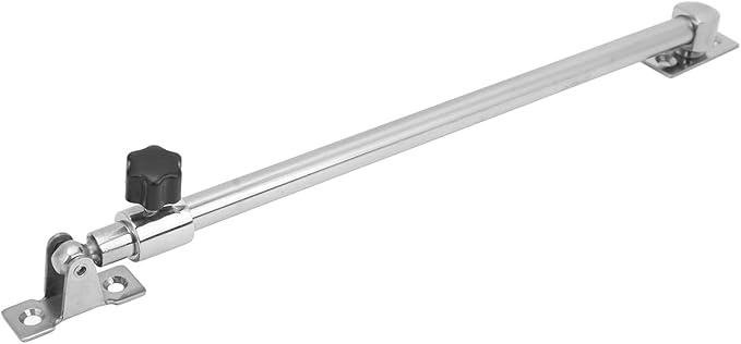

Amazon.com : Juqrelith Telescoping Hatch Support Adjuster, Marine Grade 304 Stainless Steel, 299-534mm Length - Rust Durable Construction, Easy Locking Mechanism, Ideal for RV and Yacht : Sports & Outdoors
Dale, think about how you will operate that knob behind your right shoulder with your shoulder harness on. It is lighter than my spring though.
Well … I’m thinking that the only time I’d really need to touch it would be to lock the canopy open when I’m standing next to the plane for entry/exit when loading/unloading a passenger and/or baggage.
