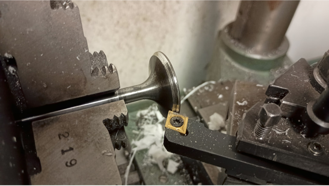

When I take the valves out of the head to lap them with the seats, they never look great. And now that I have tools to cut the seats, I’d like to clean up the valves. So in the name of science I decided to chuck up a valve in the Maximat lathe we have at our EAA chapter and give it a go.

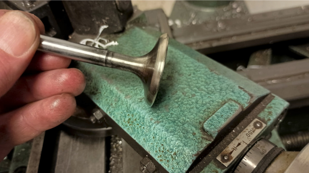

There are a few issues. My bits are chinesium carbide, the lathe is old and tired, and I’m not really very good at this. This is where I ended up after trying to do a 46 degree sealing cut and a 30 degree base cut:

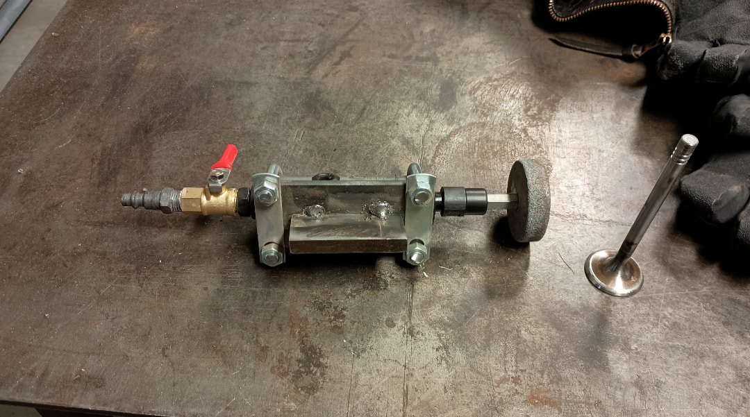

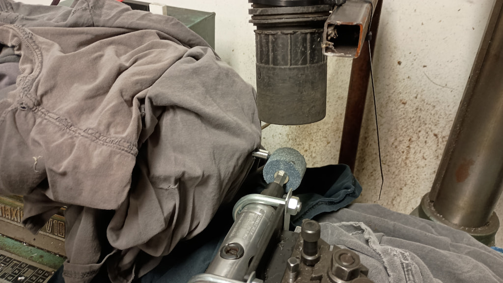

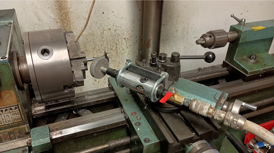

I bought a $20 Harbor Freight die grinder and a shutoff valve. I welded a piece of 3/8” steel to a piece of 3/16” and put in some slots for u-bolts.
Here it is mounted up. The palm trigger is safety wired to on, and the shutoff valve turns it on and off.
That grinding wheel is not true and the shaft is bent. I just threw it away after doing a fit check. The real ones come tomorrow and I have a diamond point coming Monday.

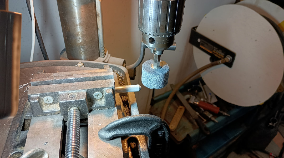

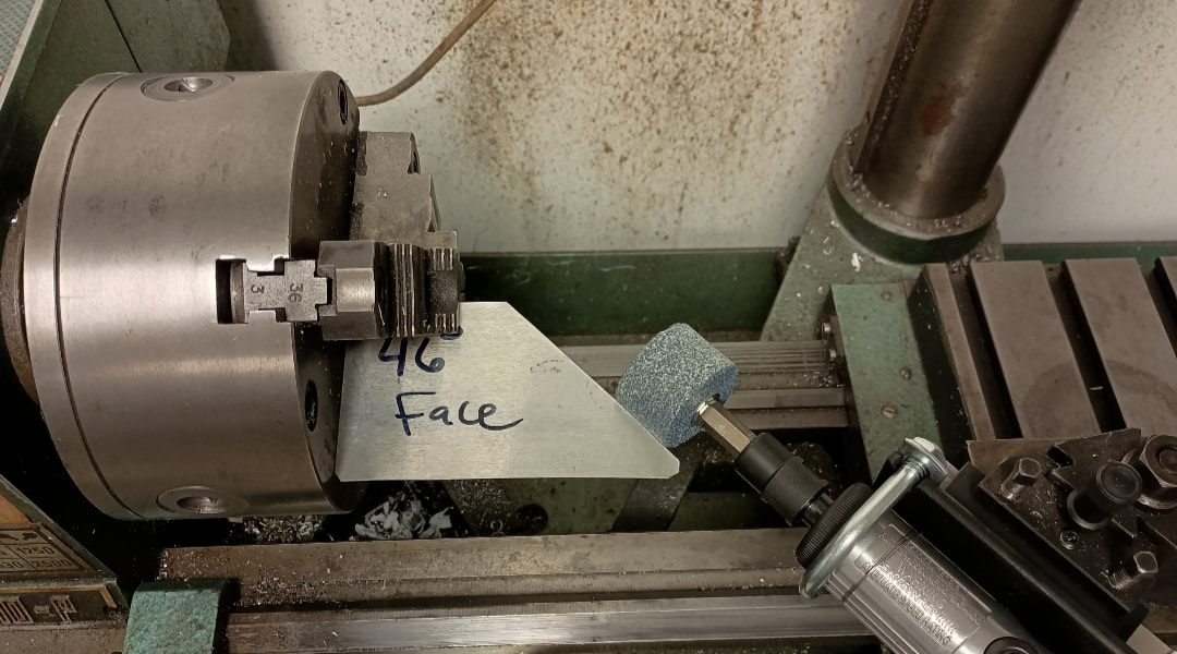

The stone was not true once I had it in the die grinder. I’ve figured out a way to do it on the lathe but will need to cover all the slides and ways. Here’s the template for the face cut. The compound slide is set at 0 degrees so I can lock the carriage and use the compound slide to pull the stone into the valve.

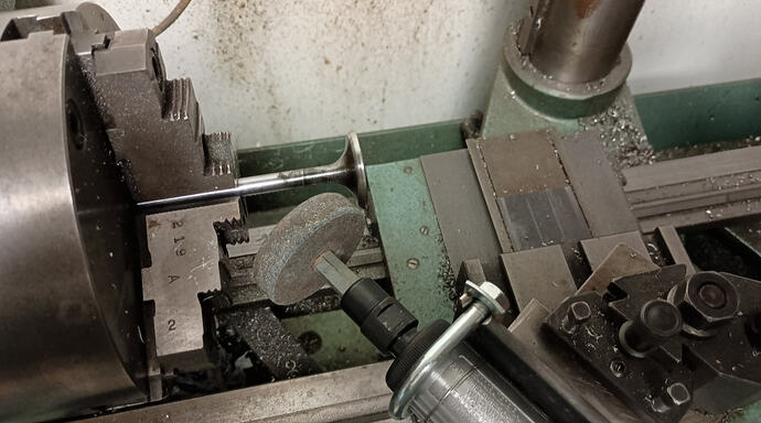

I did my first grinding this evening. Not a disaster, not ready to make it my cottage industry yet. Here’s how I trued the stone up:

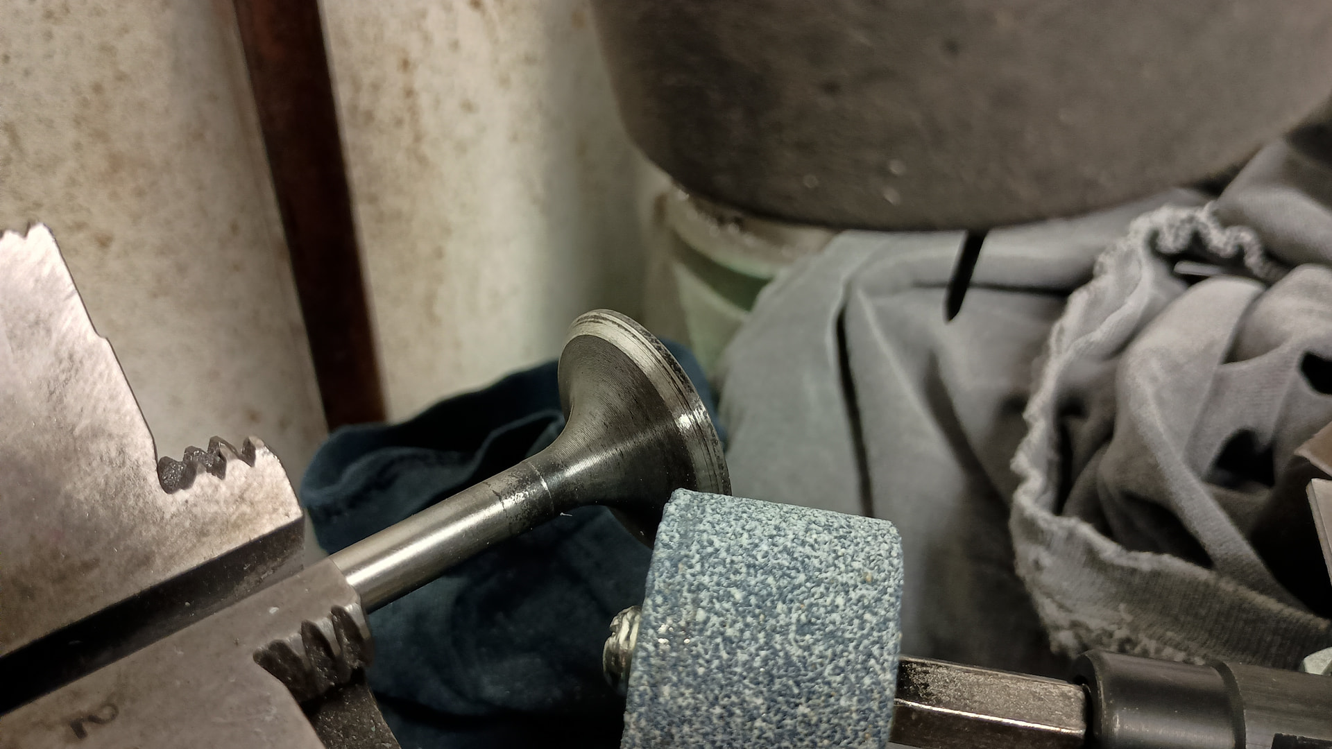

Here’s a shot of a partly cleaned up valve. The seats really deform in use, especially the exhaust valves.
Issues:
  1. The diamond point seems pretty beat already. Must be a cubic zirconia point.
  2. The HF die grinder and/or the amazon stone shake like a dog s***ing razor blades. (That’s a Sikorsky technical term from the dynamics discipline).
  3. The surface finish is not as awesome as I had hoped. Possibly due to item #2.

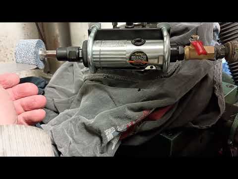

For this annual, I think I’m going to buy new valves to put in my freshly cut seats so I can get on with life. But I’m going to keep working at this. Video to follow.

The results with a tool bit were really bad. I may be able to lap out these valves. They are a lot better than how they came out of the motor. I think I just need to figure out the right wheels.
Watching the video, from both the way the grinder is removing material and visible motion of the valve as it rotates, it appears there is a noticeable amount of runout. I assume if it’s visible in video, it’s more than I’d want to remove by lapping. I wonder if machinable soft jaws would help in that lathe.
I agree. I went through the dial indicator collection that I got with the Bridgeport and they all seem like junk. Maybe rusted up or something. That’s part of the reason I’m buying new valves for now and will work this after the airplane is flying again. Unfortunately it’s an old lathe, owned by the chapter, and nobody has really taken care of it. I will probably try to lap the valves and see if they seal. A couple of the valves I did are from a junk head that had an intake seat drop out. A couple that I did are from my spare engine.
