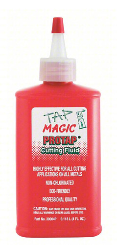

I’ve been drilling Stainless Steel lately. I’ve tried several oils to ease the pain of working with Stainless Steel. A couple of years ago I tried Tap Magic. This stuff really helps while drilling all kinds of steel. So, while I was thinking about it, I thought I’d give a shout out.

Same with drilling the titanium legs slow and low. I used that tap magic stuff and will not use it again. It has chlorine which os corrosive!!
