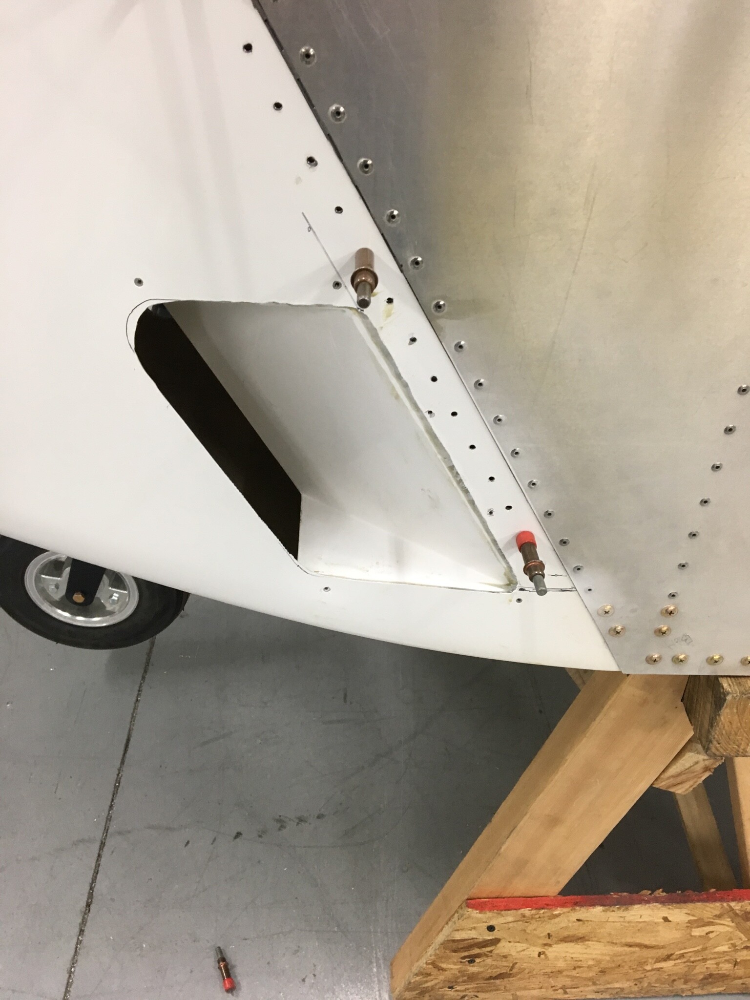

Would anyone out there with a B-model Sonex/Waiex be willing to post a couple of close-up pics of your cowling exits, and maybe provide some dimensions on them (height, width, distance from the rear edge of the cowl, and depth of the scoop on the interior)?

On a B-model Xenos, the optional cowl vents are parallel 2" from the aft edge of the cowl for a vertical opening of approximately 9-1/2" and 3-1/2" wide. The vents are part numbers SNB-P16-06L & R.
The drawing incorrectly calls for part numbers -P13-05L and -05R in detail P “Locating Optional Cowling Vents”.

I too am interested in the side vents. Are they not simple louvers? I have not heard of scoops on the interior, but maybe so! I do have a 25% larger belly opening with the appropriate seaplane lip installed per plans. I have taken a picture of a Sonex at Osh 16 with the louvers, but did not investigate the interior for scoops.

I purchased a pair of the b vents from sonex. I think they were about $122 for the pair. Fiberglass and gel coated. L & R. They have a flange to mount on cowl. Either glass them in, or i riveted mine on. Yes there is a big scoop on the inside.

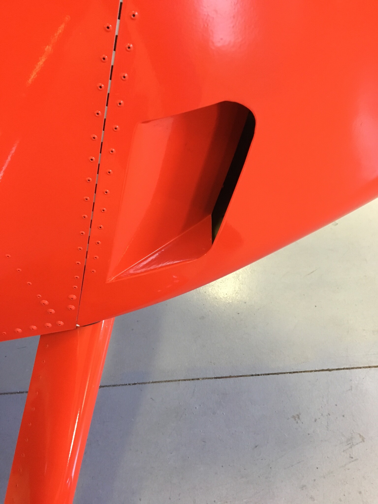

I have a photo from a Sonex in they’re shop. I’ll try to post it here. I asked Kerry where they are placed and his reply was 6.5" down from the top of the bottom cowl edge and two inches forward of the trailing edge.

Lbrandt wrote:I have a photo from a Sonex in they’re shop. I’ll try to post it here. I asked Kerry where they are placed and his reply was 6.5" down from the top of the bottom cowl edge and two inches forward of the trailing edge.
Resurrecting this thread to ask if anyone who installed side vents on a legacy Sonex to supplement the bottom exit saw increased cooling performance (ideally with the Jabiru).
One of our buddies from Sonexbuilders, Noel, put them on his A model AeroVee turbo. His temps are acceptable but I don’t know if he credits the side exits. I bought a set but have not installed them. I may not need to.
