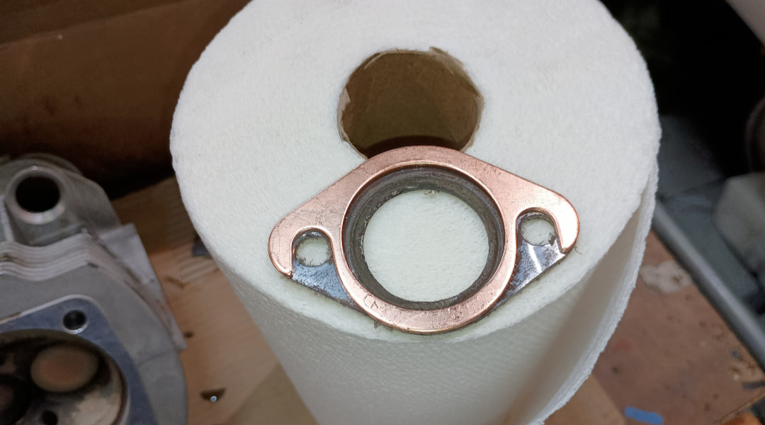

Here’s the new and old gaskets together. The hole in the copper gasket is bigger.

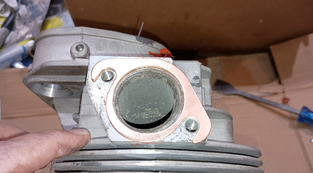

Here’s the gasket on the head. Gasket is bigger.

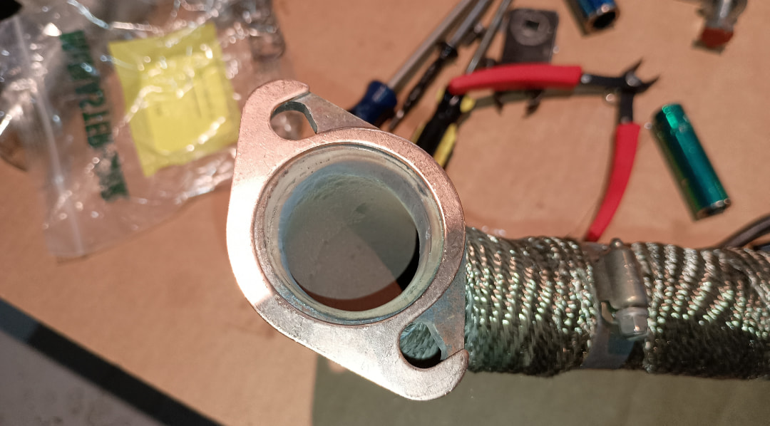

Here’s the gasket on my pipes. I blended out the ID by the flange and the gasket matches nicely.

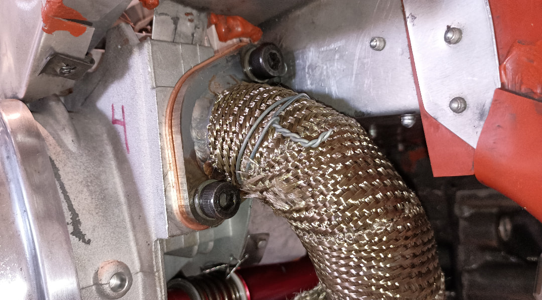

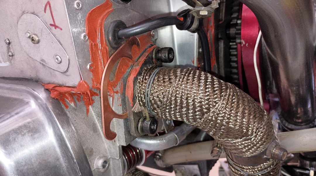

Here’s #1 going on.
Here’s #4 installed.
It’s a better experience installing them as compared to the stock gaskets.
