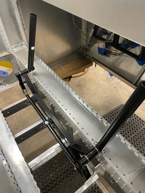

I have done it using the kit Sonex has. Not a big job as mine is still under construction. I’m sure it could be done in a finished one but was no big deal with no bottom skin.

There is a dual stick kit for the B Model now check the Sonex website. It also makes improvements to the seat pan and accessibility of it in case you want to mount your servos in there.
