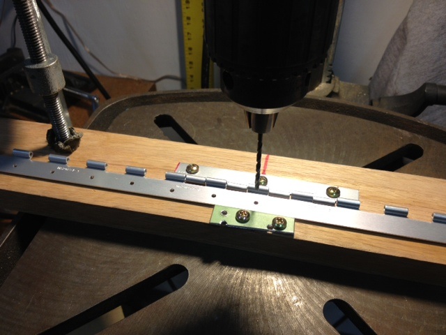

I recommend you buy an alum 3 ft. yard stick and drill #40 holes on each inch mark. Use this as a drill guide to predrill the hinges.

Onex107 wrote:I recommend you buy an alum 3 ft. yard stick and drill #40 holes on each inch mark. Use this as a drill guide to predrill the hinges.
I believe the yardstick is also handy for getting the right positioning on the control surface. You lay it flat on the table against the control surface, and put the hinge loops on top of it.
This is what I used to drill all my hinges:

Using a yardstick with predrilled holes is a “pretty good” idea, but not ideal. For one thing, there are hinges longer than 3’ to consider. Another is the actual indexing of the hole spacing, and finally, the holes in the yardstick will tend to wallow-out with use.
It’s quite easy to make a dedicated “hinge hole indexing tool” that will make repeatable holes in a hinge-half of any length.
PM me your email and I’ll send you pictures of my set-up. FYI…I copied someone else’s rig and their pictures may be here on this site somewhere.

Area 51% wrote:FYI…I copied someone else’s rig and their pictures may be here on this site somewhere.
Maybe two posts up?
Re: control surfaces
Posted: Tue Aug 31, 2021 12:41 pm
That wasn’t there when I hit submit. But yeah…something like that. Or exactly like that.
