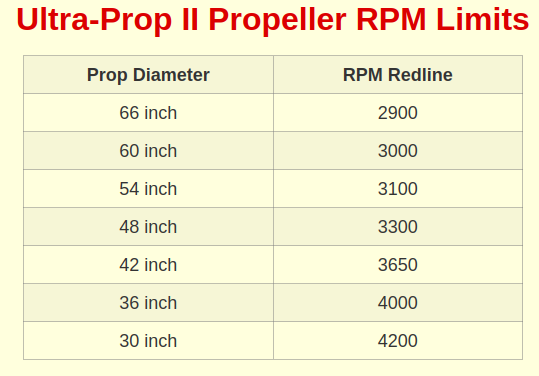

Edit: I found this table.
So I’d say no way. Seems like a bad fit. Even the RPM limit for 54" is too low for our application.

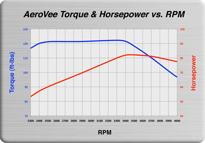

From the HP/torque graph you are down a full 10HP at 2900.
Also, apparently these props are not intended to be used in direct drive applications.
As stated on their web site:
We ship WORLD-WIDE, the Original Ultra-Prop and the new Ultra-Prop II Solid Carbon Fiber Composite Propellers. Use with belt or gear reduction-drive applications and electric direct-drive.
