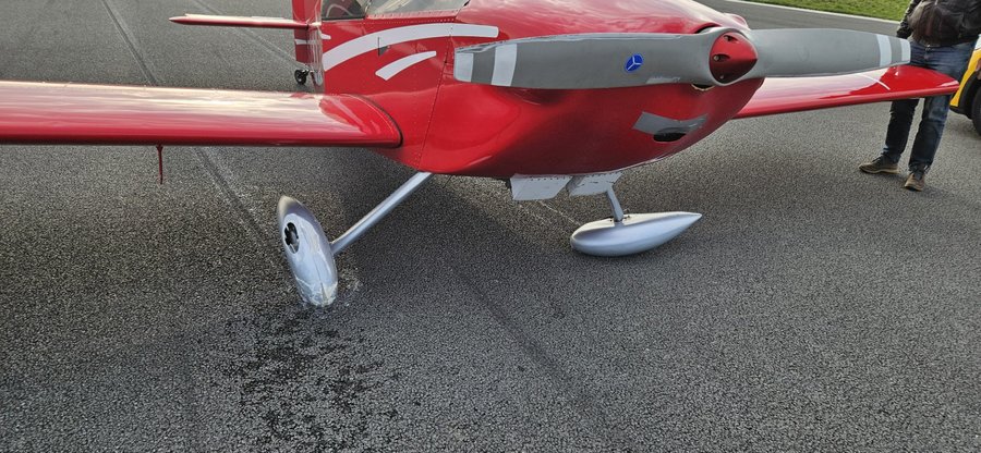

In March we had a mishap during landing. The bolt holding the axle snapped and the wheel rotated. Luckily no nose over. Pffft.
We made up a report of the fix.

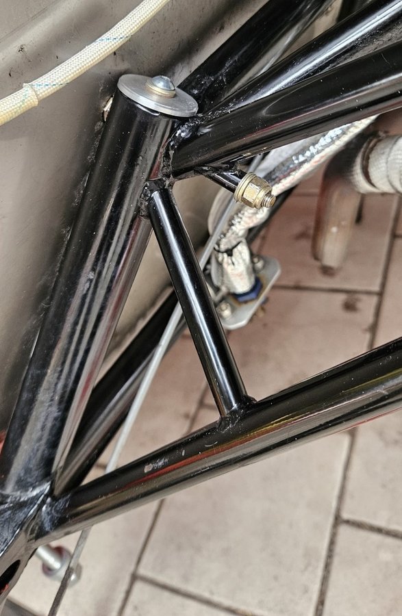

I saw this situation developing on my Xenos. This is my fix:

I’m a little curious on the damage of the Sonex pictured above. The left axle is obviously broke but how did the damage occur on the right wheel pant? It looks like the wheel pant itself was dragged on the top surface, perhaps by a broken weldment holding the wheel pant bracket in place?

MichaelFarley56 wrote:I’m a little curious on the damage of the Sonex pictured above. The left axle is obviously broke but how did the damage occur on the right wheel pant? It looks like the wheel pant itself was dragged on the top surface, perhaps by a broken weldment holding the wheel pant bracket in place?
When the left wheel rotated it pulled so hard at the brake cable the right wheel blocked and the weldment at the right axle holding the backplate of the brake broke. The wheel pant is mounted to that plate so it rotated with the brake plate. I think acting as skid now it prevented a nose over and/or ground loop.

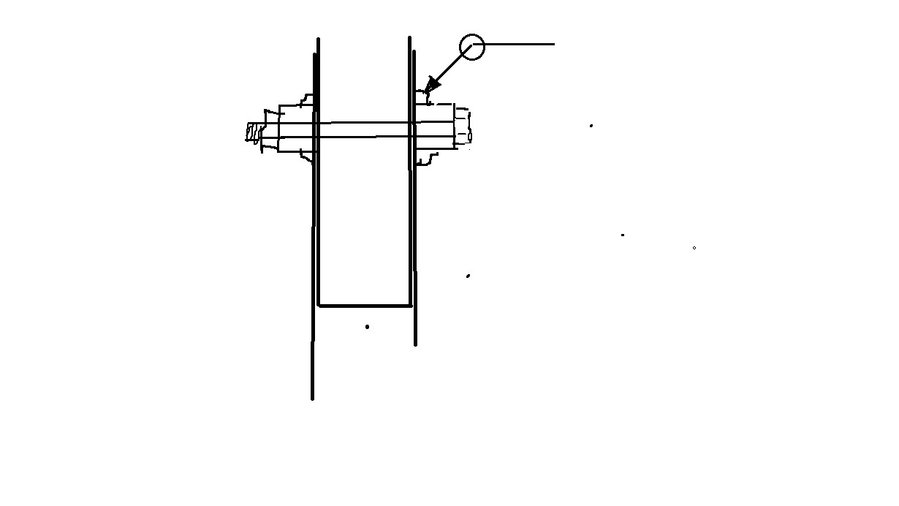

For the top bolt we’re aware of the SNX-SB-006 and have the AN bolts in and we check them every annual inspection by rotating them and see if it’s still one piece. When dismantling the bolts showed severe damage and where at the point of snapping. From now on we’ll simply replace them at every annual. The same goes for the bottom bolts.
To prevent loosing the gear leg in the event a bolt will break and drop out I’ve put a disk at the top end. The bolt holding the disk is just long enough to clamp the top bolt in place.
