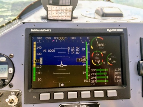

by RodgerC
Nothing like a photo…119 kts at 3160 RPM and 1960’
Note also the battery condition, thanks to the new Jabiru 12 pole stator
