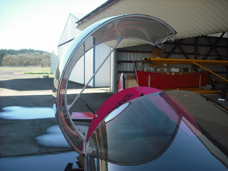

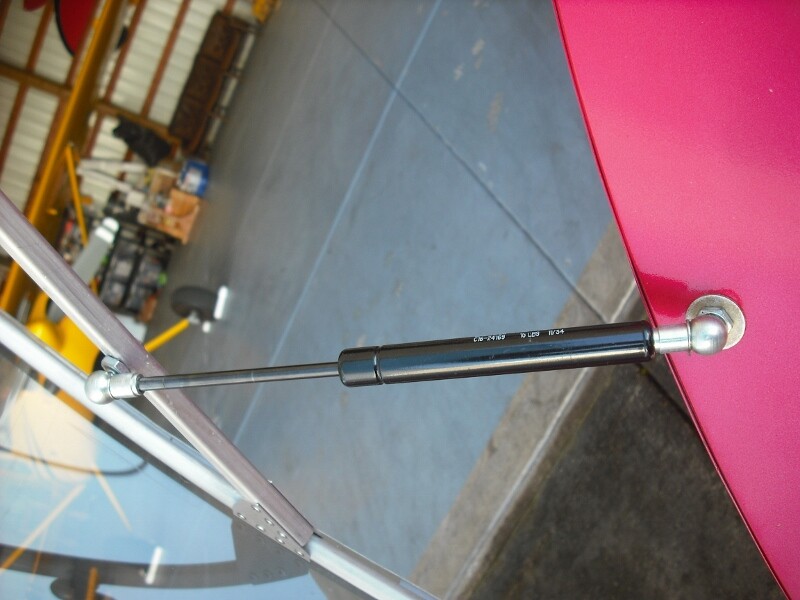

I have used a gas strut for 3 years, and have had no problems. It is a 15-lb. strut, 7 inches closed, 10 inches open, ball joints both ends, from McMaster-Carr.
Bill
inside 006 (800x600).jpg (338.55 KiB) Viewed 2276 times
inside 004 (800x600).jpg (336.35 KiB) Viewed 2276 times
