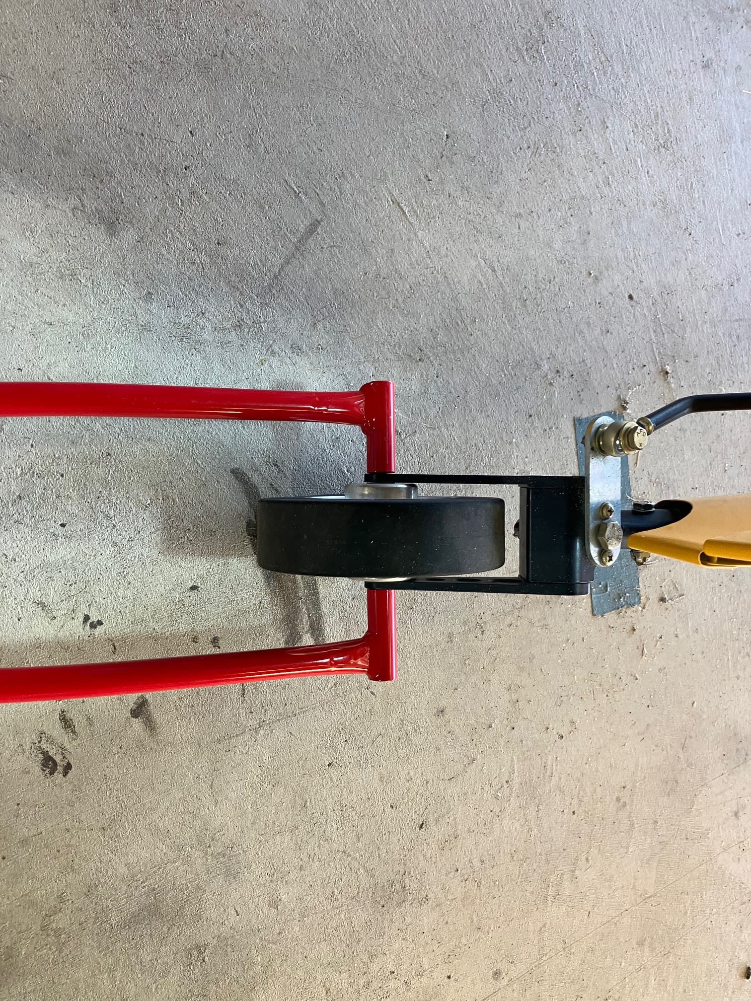

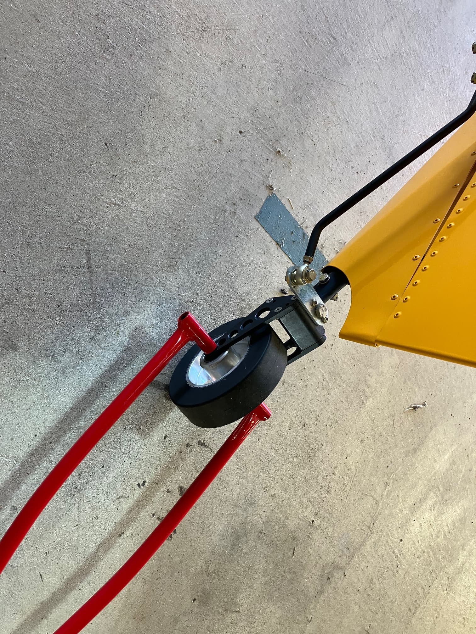

Here’s a couple of pictures.
Bill
Thanks, Bill. Looks like a great fit!
We left off the ventral fin and just grab the tail spring. Problem is that it’s usually oily because we have VW power. So it does not pick up the tailwheel like the classic taildragger dragger?
Bryan,
You are correct - the tailwheel is not lifted.
Of course with our steerable tailwheels - that means that you cannot turn sharp unless you reach down and lift the tailwheel up off the ground.
However, I find it much easier to move around using the Bogi-Bar - than lifting the airplane any time I want to move it. I turned 70 this year and those things don’t come as easy as they once did.
Glad I bought it - no regrets.
Bill

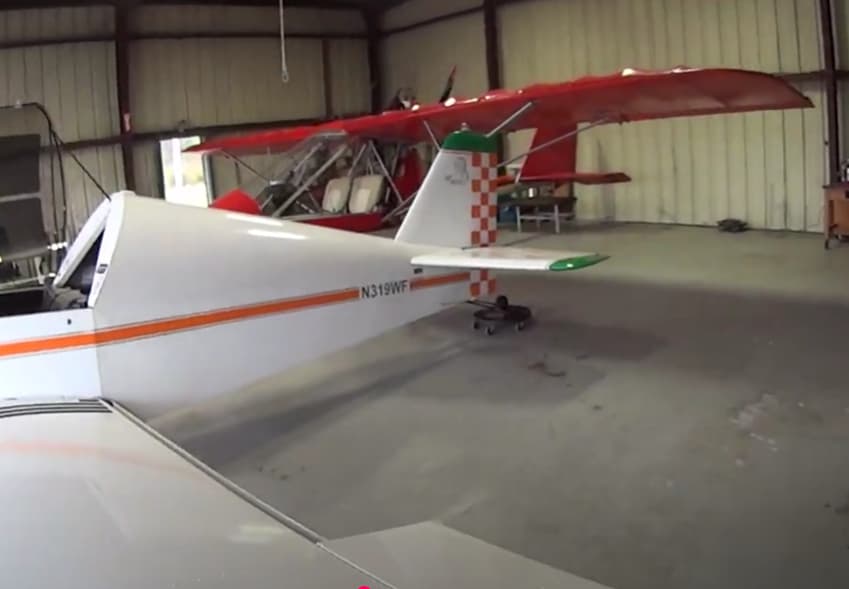

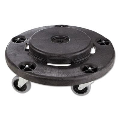

Our hangar floor is pretty flat as is the pavement in front. I have been using a Rubbermaid can dolly under the rear wheel. I strap it on with a single bungee cord. Allows the tail to turn as needed and makes rolling the plane in backwards a snap.
It has a recess where the tail wheel fits quite nicely too.
