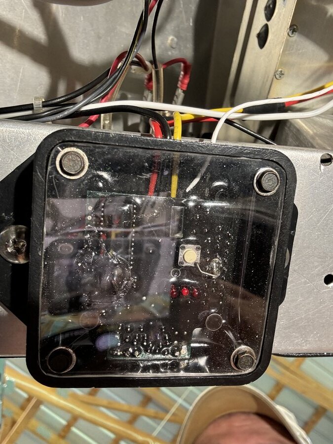

Any one have an idea on what fuel calibration system this is. I can’t find any info on this one to read on how to recalibrate.
Here’s a picture

That looks just like the old Princeton Probe calibration box. Except, someone replaced the black cover with a clear one. Princeton was purchased by RED Avionics. The calibration instructions are on their website and are easy to find. They had a type with 2 set points, empty and full, and one with 5 set points. If you call RED and ask them, they will tell you which one you have.

pappas wrote:That looks just like the old Princeton Probe calibration box. Except, someone replaced the black cover with a clear one. Princeton was purchased by RED Avionics. The calibration instructions are on their website and are easy to find. They had a type with 2 set points, empty and full, and one with 5 set points. If you call RED and ask them, they will tell you which one you have.

I forgot to mention. There is likely a model number and information label affixed to the back of that box.

I did end up recalibrating the system as per the instructions and all was going good until the end. Filled the tank with 15th at a time and calibrating it at zero, 1/4, 1/2, 3/4 and then full with 60 Lts at 5he end. Finished it off and it only. Now shows 45 lts at full so I have to drain it all again and start from scratch.

That’s typical. For all of my calibrations, regardless of what probes I have used it usually took more than one fill, calibrate, drain, repeat cycle. Usually, because I forgot to push the button after one of the fuel adds.
I went through the same thing a few months ago when calibrating the new RV7-A, and I was looking out for it! I’m sure you will get it.
