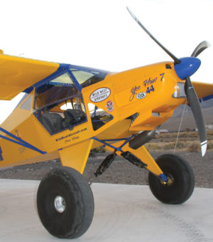

Yeehaw 7 kind of points the way… Although cowl on the sonex doesn’t have that flat space below the prop for the intercooler. And that’s for the 300hp, I don’t think anyone’s planning on using that one?
Or you follow Thomas/Edge’s 912 in a sonex - and just use those stock cowl inlets and 2 radiators.
It’s a different sound - I’ll give you that. The turbo version sounds much nicer to me than the NA; But that could be the muffler used on the local NA too.
