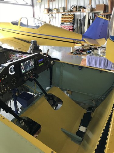

TE, Pitot & Static Tubing
Carlos,
Here is a picture of the cockpit right side. You can see the three 3/16" al. tubing coming in the cockpit up high then having to go down under the spar. I’m saying ignore the plans and install these lower when coming from the tail so they are not such an eyesore.
Rick Caldwell
Xenos 0057
Any tips or suggestions when building the Tail Cone?
Posted: Tue Oct 27, 2020 2:06 pm
by Carlos Trigo
Thanks Rick
In the other hand, if I decide to use the cosmetic panels they send with the kit (at least they sent me, I don’t know if they used to send them back then), I will have no problem with the tubes being high in the cockpit side.
Unless you tell me that they cannot go through above the main spar, just below the bottom of the instruments panel.
Is this possible?
Regards
Carlos
Re: Any tips or suggestions when building the Tail Cone?
Posted: Tue Oct 27, 2020 3:38 pm
by racaldwell
Carlos,
Yes, you could do that. I just want to maximize the width on the cockpit and I like the look of the structure. I want to minimize the runs over the spar. There is a rudder cable and an antenna cable on each side currently.
Rick Caldwell
Xenos 0057
