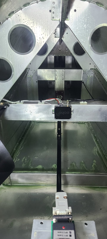

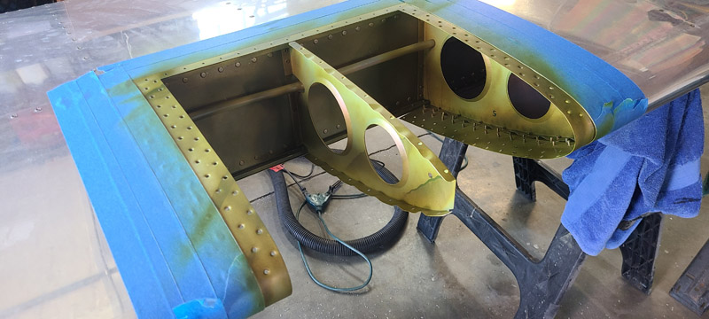

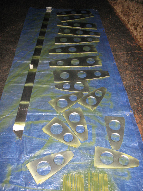

From the build log pictures - my builder used zinc chromate primer on all faying surfaces in the wing and tail feathers.
During a wing repair I did same.
I also Corrosion-X anything else I can get to. Just this week during the Condition Inspection - after the empennage was cleaned and inspected it was wetted down with Corrosion-X. I also injected the main spar box with same.
I am located on the coast and fogging with Corrosion-X or ACF is a way of life. And while it is true that Piper and Cessna did not use primers inside their planes (well Cessna did on their floatplanes) - they are built of heavier gauge material than these LSA’s. They can take a little “frosting” - for us - that’s the beginning of something serious!

If I was going to prime, I’d do like Graeme’s builder did - a light coat on faying surfaces.
Considering Graeme is outdoors on the coast, what he has plus the corrosion-x is a good thing. I’m in the Midwest, and in a hangar. So it depends on your situation as well.
