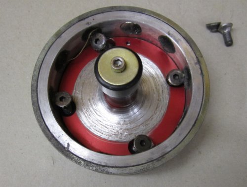

The alternator failed because the trigger shaft assembly flat head screws had worked completely loose and fauled the alternator stators.
The ring with the magnets ( installed when recieved in the kit) was also Loose, all screws loose ,but still in place , one screw broken as can be seen in the picture.
The trigger shaft was installed according to the manual with locktite on the screws.
I was fortunate that this happened on ground.
Kurt Nielsen
Aerovee# 296

Were they 5/8" long patched screws or the non patched 1/2" long screws? There was a service bulletin out for aerovees 2012 and earlier for this exact issue.
Keith

About all I can say is : “EXPLETIVE” !
So as the screws were progressively backing out they were buggering the windings, so the CB tripped.. until it failed completely
The insulation check would have indicated the shorted windings, may have saved a complete failure but it would have been same cost to fix I expect

Keith
My aerovee is no296 ie 10a alternator and thus not covered by the bulletin.
Kurt
