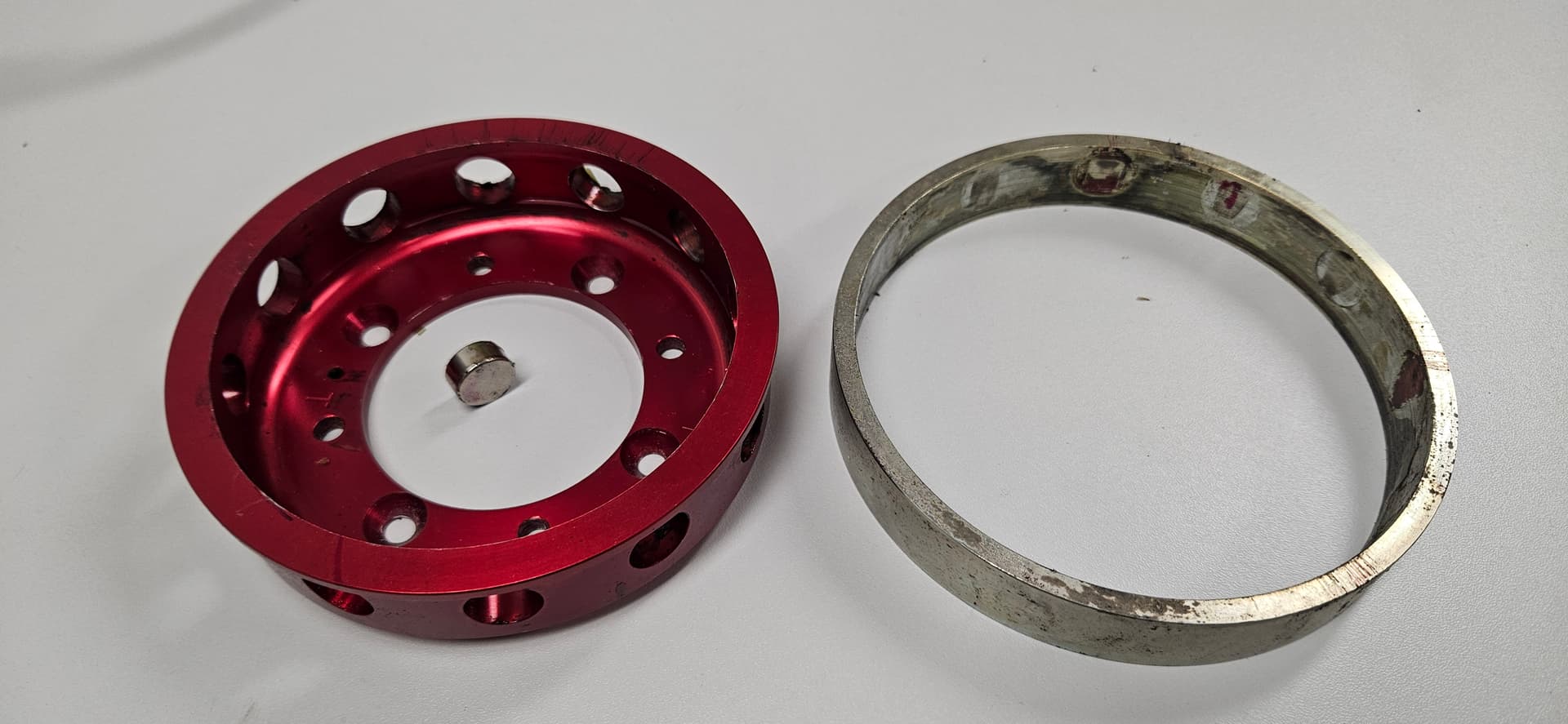

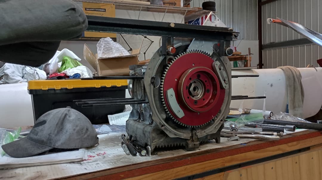

@brs , here’s a picture with my nifty flywheel holding tool.
Thanks for posting the pic Bryan. Wow, looks like round magnets in blind holes! Hope there are holes behind the steel ring.
Not new to the Sonex forum. I was on the old one for years.
In the end it was easy. It didn’t took too much force to get the ring off.
6 magnets still strong, 5 intermediate, 1 allmost nothing.
Thanks for the picture AlexZ. Did you use a gear puller or something?
I have a small hydraulic press. It’s not that tight. So, you could do it with a hammer.

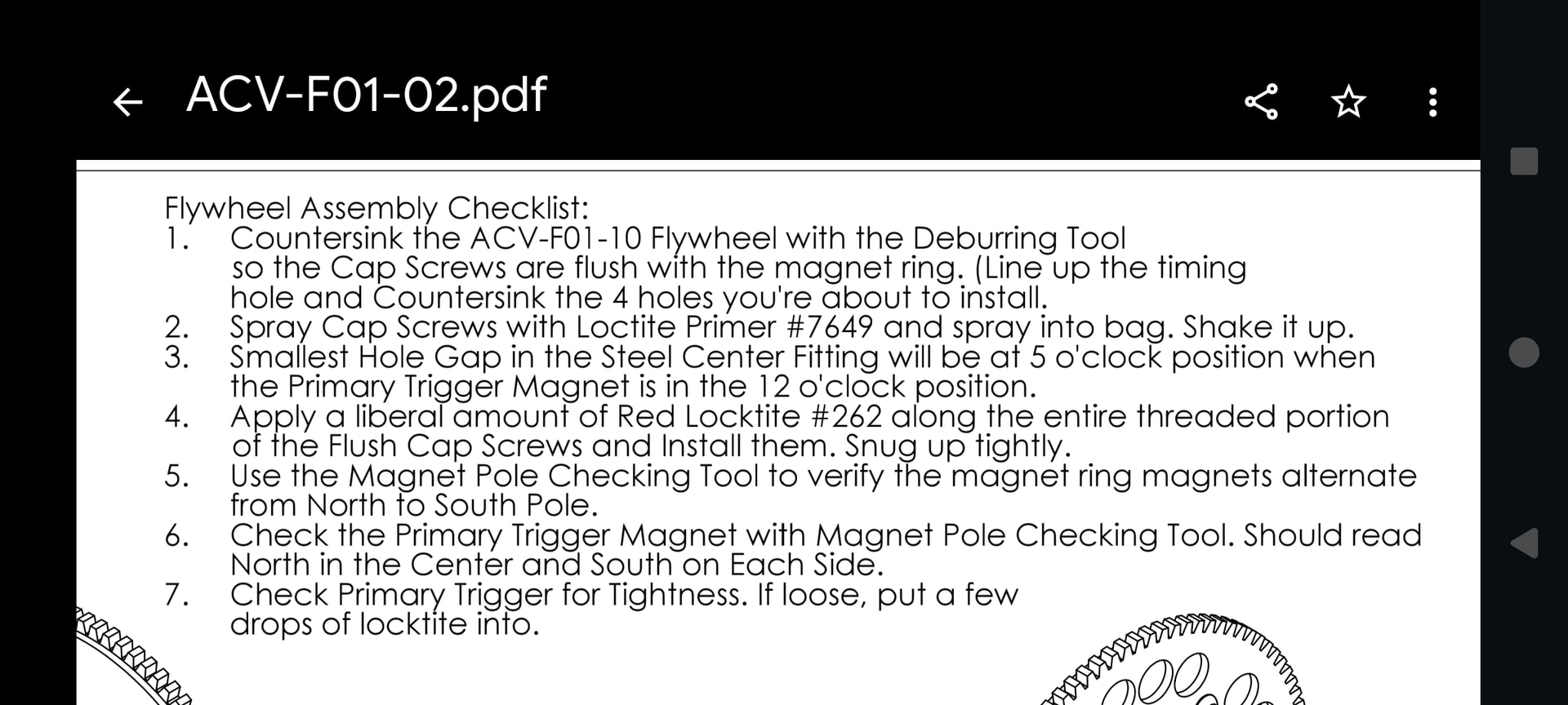

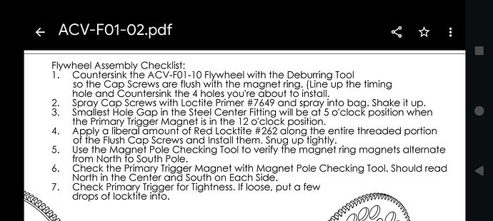

Is the north / south orientation of the magnets in the stator ring important? I didn’t give it a thought until I received them from Sonex and they are marked. my first thought was to put them all in oriented the same way but it best to ask the experts!
That won’t work - they need to alternate north and south to make power. Definitely important!
