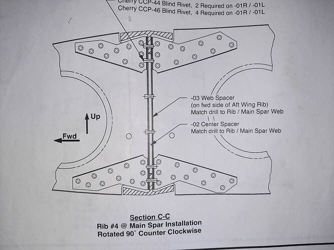

Roberto, could I just clarify something with you? The forward ribs all line up with the forward flange of the spar cap but many of the main ribs don’t line up with the rear rear flange of the spar cap. The drawing shown below shows one of the inner ribs. You can see that the ribs don’t line up with the rear flange but a continuation of the curve will line up with the forward flange. Hope that makes sense.
I hope I’m not telling you something you already know but I recall when I built my Sonex I was quite surprised by this feature although it does make sense (eventually).

peter anson wrote:Roberto, could I just clarify something with you? The forward ribs all line up with the forward flange of the spar cap but many of the main ribs don’t line up with the rear rear flange of the spar cap. The drawing shown below shows one of the inner ribs. You can see that the ribs don’t line up with the rear flange but a continuation of the curve will line up with the forward flange. Hope that makes sense.
If I were a betting man, that is what I would think is going on. The rib flanges on the aft ribs do not line up with the surface of the spar cap at the aft edge of the cap - they’re not supposed to. cleco those ribs in place, then cut some strips of .025 to lay on the ribs as a test of how the skin would lay. What you should see is that the aft skin will continue the plane of the rib flange - it will be above the spar cap surface at first - but then lay on the spar surface after passing the “peak” or center point. This is most noticeable on the inboard ribs.
