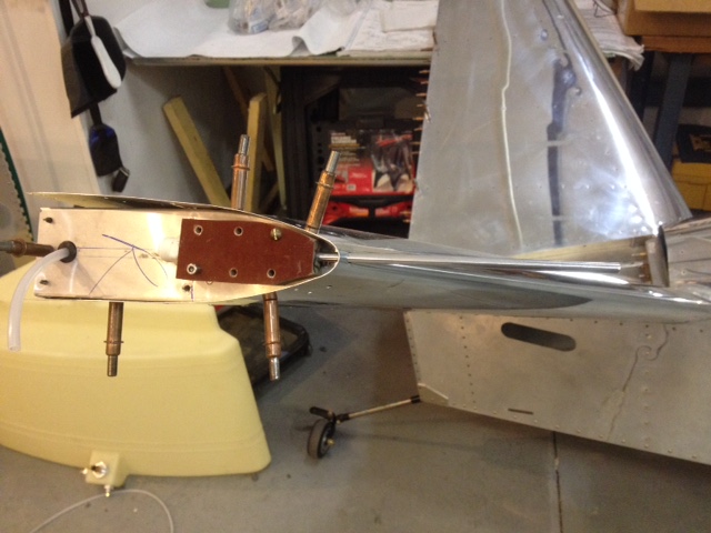

Whats a Sonex “standard pitot/static arrangement”?
I have pitot/static & AofA all on the same home made mast, located right wing. :smiling_face_with_horns:

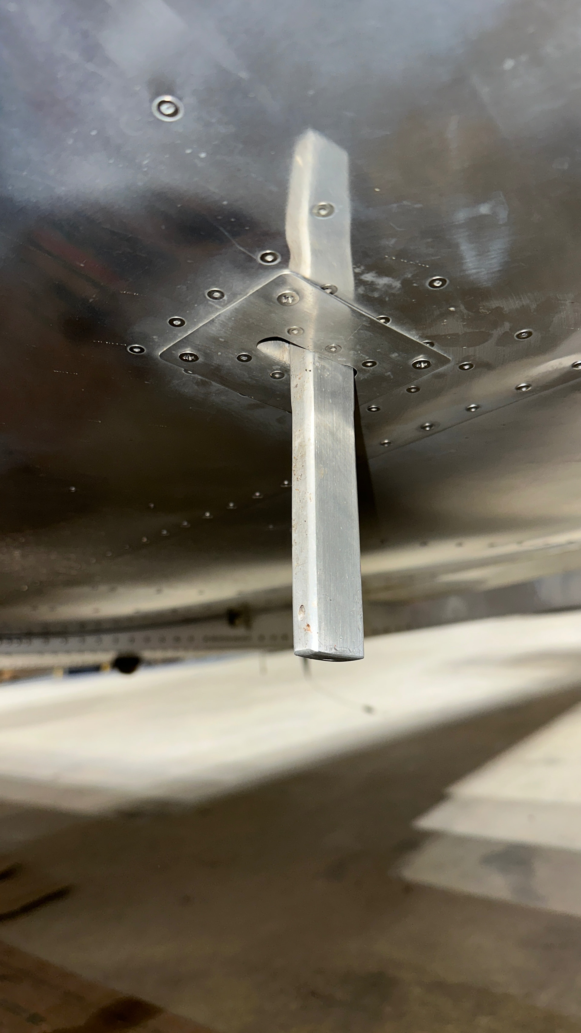

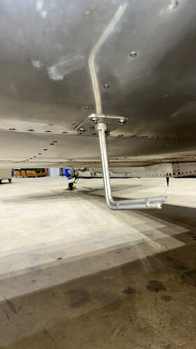

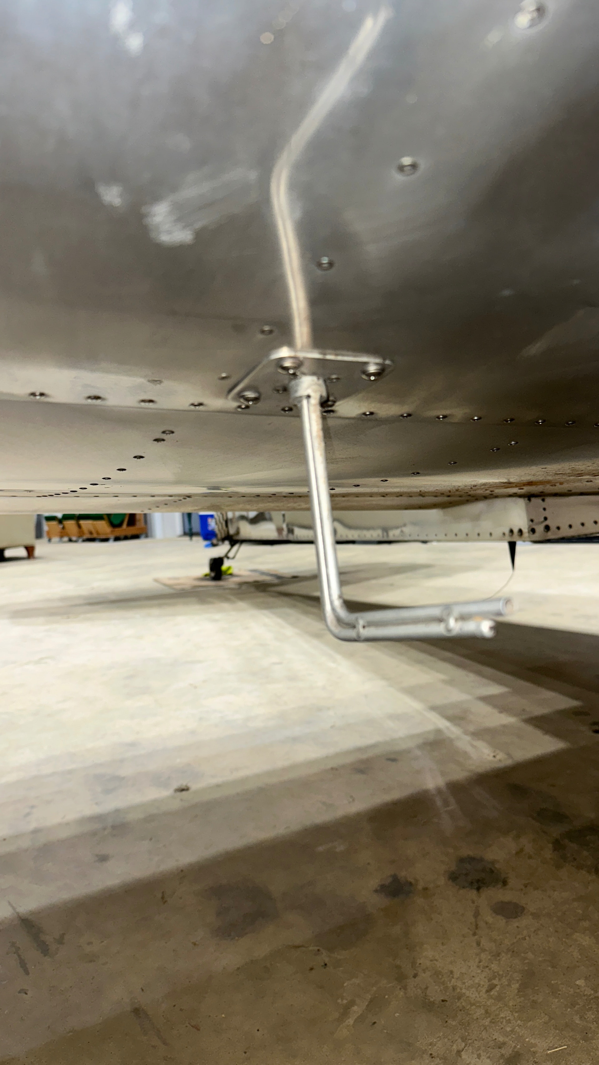

For many of us the standard pitot/static arrangement is the ACS probe mounted where the plans show.
The two photos here are LRI and my pitot/static. The LRI is installed in exactly the same place as the pitot/static, but under the left wing.
Lots of dead Texas bugs visible…
And then you have the Waiex rebels.
Where do you have the static port?
