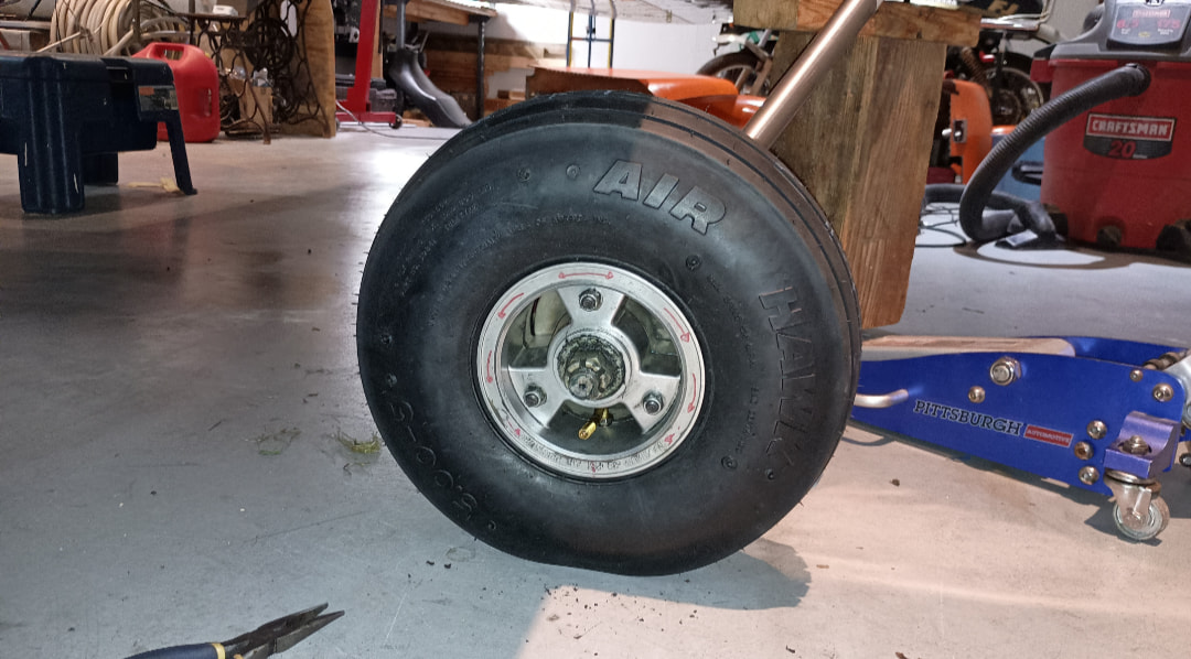

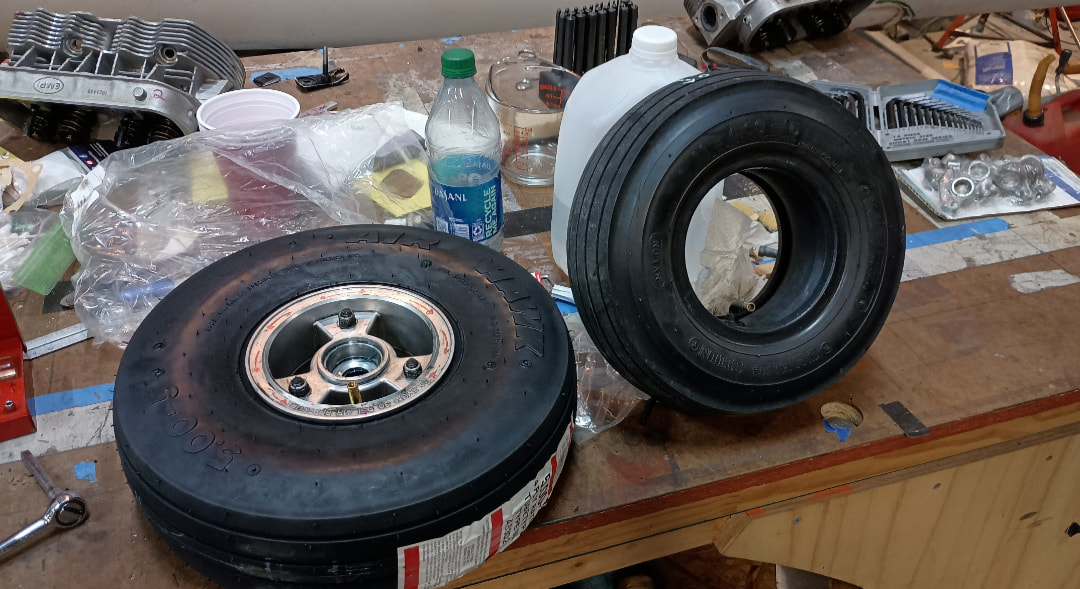

I recently disposed of the wheel pants on my plane and installed the larger tires described above after removing the factory 11-4X5’s. I gotta admit that the difference is more than I expected. The plane feels so much better during the take-off and especially the landing roll out. It simply feels much more attached to the pavement and seems to be more controllable with much better behavior.
Maybe it’s just my imagination but, to me the change is quite noticeable and welcomed. My initial test pressure has been 30-32 PSI and thus far that has worked well. Obviously these tires have a larger contact patch and perhaps that is what is making them feel like they stick to the surface much better.
But they seem to roll easier and steering (whether with rudder or tail wheel) feels more confident.
Or maybe I’ve finally learned to land this thing! Nah, can’t be that …
I preached against the big, heavy tires before but after we have flown to a lot of grass trips I’m trying to lose weight to justify the extra mass of the larger tires. On some of the strips we have been to it is like the brakes are on - high power required to taxi. Takes a really long time to get up to flying speed.
I’m guessing that with the removal of the wheel pants the weight difference is not much especially after all the fiberglass and metal I added to the old pants because of cracking when flying from grass fields.
I might lose a bit of speed without the pants but I retained the leg fairings. I haven’t performed any real testing to determine speed loss but it doesn’t seem to be much if any at all.
So far I believe the trade off is worth it (except the cost of the new tires and tubes - OUCH!)

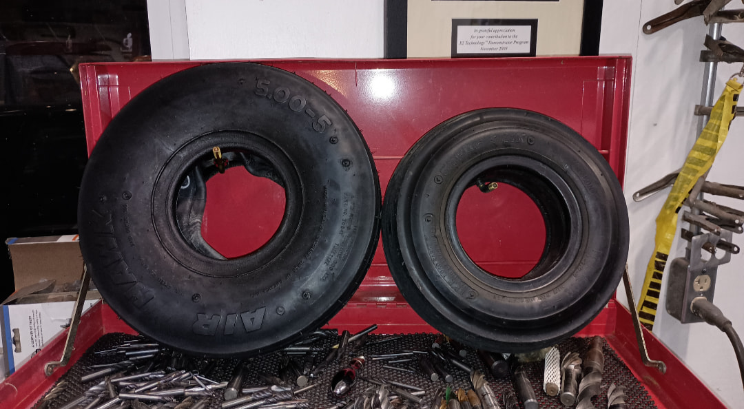

Early on, most of us began flying with the 5x5 tires but eventually switched to the smaller tires seeing little advantage to carrying around 3 1/2 # more weight. Even Tony Spicer, who flew off of a grass runway, switched to the smaller tires. The fellows who operated off of grass runways frequently complained more about the tailwheel digging in than the main gear tire size being a problem.
Maybe, surprisingly, in addition to the weight savings, you’ll find that braking is better with the smaller tires if that matters to you. But anyway it’s such a cool thing that with experimental aircraft, you alone get to decide what works best in your opinion.

I have the Air hawk (Cheapest option I could find @ $108 usd each) 6 ply tires, flown these since new so I don’t have a comparison. When these wear out, I will replace them with the 4 ply version to save a bit of weight. I have been running them at 50Psi without any issues. And yes, I too find it strange that the tubes cost more than the tires…

Having flown with the 500-5 Air Hawks for a few hours I learned that I should have put on these larger tires earlier. We had another Young Eagles Fly-in last weekend and flying young, future pilots off of the grass field with the larger tires (and a 5" tail wheel) was uneventful and the plane handles grass and pavement very well.
I do notice with the larger tires that the TOB brakes are not quite as effective but the difference is quite negligible.

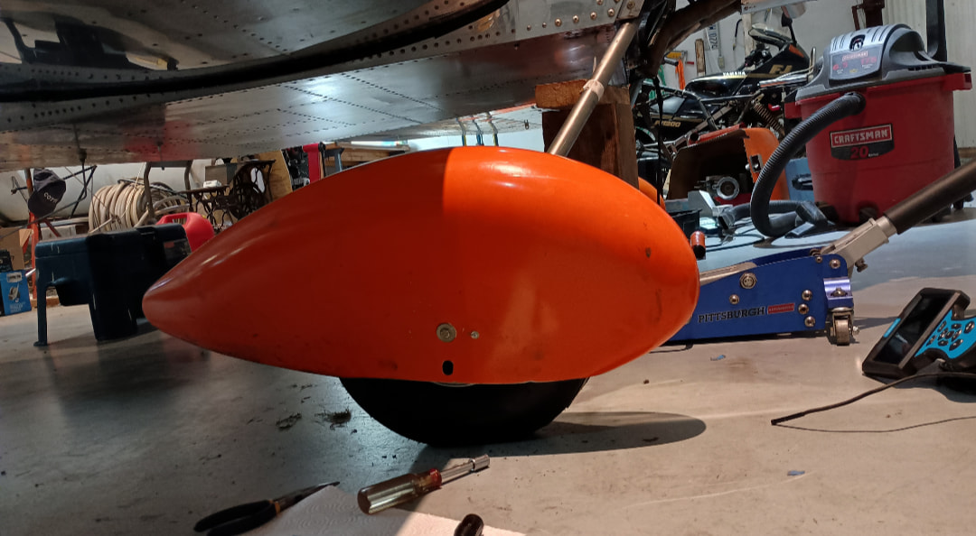

I don’t know of any source for off the shelf PRP to fit the stock Sonex tires. I have a set of the older pressure recovery pants that were used on the nose wheel of Van’s RV12 aircraft. I believe that now you have to be a Van’s builder to buy such items from them.

I have one of these on order from Aircraft Spruce, they look sort of PRP. Wheel Pant 5 White Aero | Aircraft Spruce ® I plan to use it on my nose wheel, as I can’t stand the way the stock nosewheel pant looks. I think they are made to order, so I might have it by Christmas? Hope Dies Last…
April 2026 UPDATE: Didn’t like them. Ended up using a Sonex main gear pant for the nose gear.
I haven’t tried it, but I find it highly unlikely they will fit - they are wider, AND bigger in diameter. The stock nosewheel pant is a pretty tight fit on the Cheng Shins, and I don’t think the stock nosewheel fork will clear either the width or diameter.
