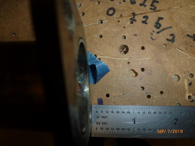

I cheated. I gave up and spread the flanges apart a little. I laid the exhaust on a table, marked where the flanges were, and carefully spread them with a hydraulic jack. Care must be taken because the stainless yields all at once. I spread them 1/8”. Not the best solution, but I was out of patience.
