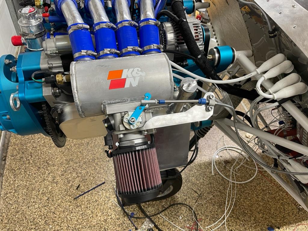

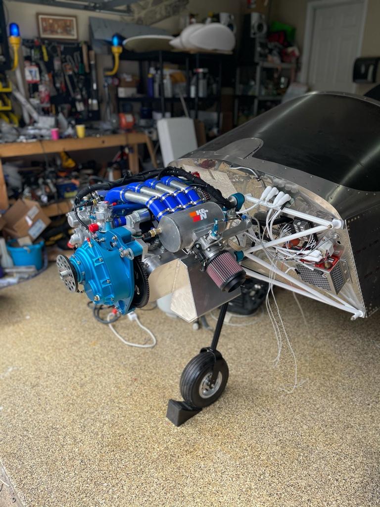

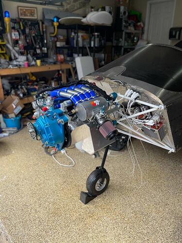

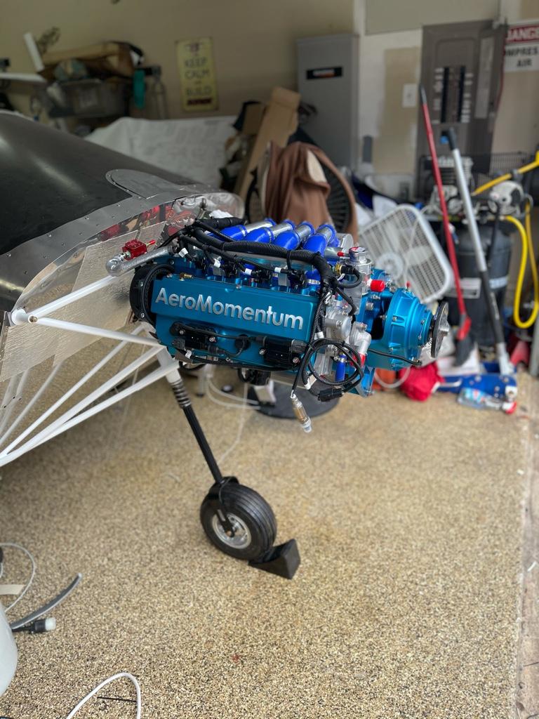

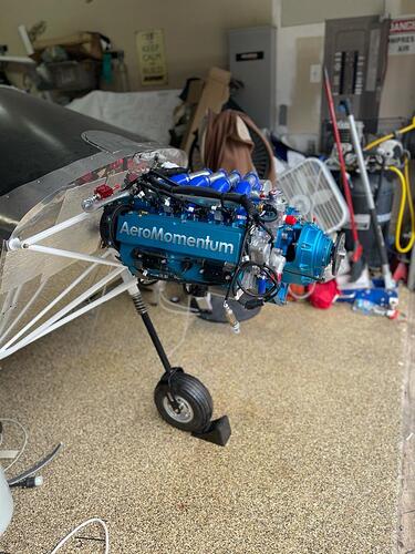

I have made some decent progress since my last post.
Things completed on engine install:
  1. Was able to install the modified Aerovee mount and got the engine mated to it.
  2. Just finished up running new wire and mounting and wiring all the sensors needed for the Garmin EFIS on the firewall side (as of today there’s no way for the AeroMomentum’s ECU to speak with Garmin’s proprietary CANBUS).
    These sensors included:
    MAP, Oil temp, oil pressure, fuel flow supply, fuel flow return, fuel pressure, coolant temperature, gear oil temp, alternator shunt (ammeter), battery shunt, and tachometer integration. Also modified the harness for a relay for the coils/fuel injectors.
  3. Was able to successfully mount the throttle cable and removed the two firewall fittings used for the Aerovee throttle and mixture.
  4. Fabricated and installed new 4ga wiring for starter/alternator/battery contactor.
  5. Fabricated and installed 2ga ground wire to engine block.
Things to do to complete engine install:
  1. Terminate sensors into the Garmin GEA-24 (engine monitor).
  2. Terminate ECU power supply and fuel pumps into existing switches on panel.
  3. Change switch cover plate.
  4. Mount ECU in cabin.
    4a. Tidy up wiring with wire loom, zip ties and tape.
  5. Mount fuel pumps on firewall as well as fuel line supply and filter.
  6. Install fuel return line into tank.
  7. Install and fill radiator.
  8. Install exhaust header.
  9. Patch old holes in firewall with stainless sheet metal.
Here are some pictures below.
The three wires hanging are for the fuel pumps.
Modified the harness for the sensors, removed unnecessary wiring for AeroMomentum’s proprietary gauges. Wire loomed everything and made it look neater as well. The coiled wire on the right is the O2 sensor used to help lean out the engine.
Throttle completed and yeah I had to put the K&N sticker on.
I’ll update as more is done. Hoping for first start-up by the end of the month but don’t want to jinx the progress.
-Tim

Hey Jeremy,
After some time off for health and life events I am back at it, building the Sonex. I have the AM15h mounted on the front of my B-Model. Mounted the wings friday and I am currently working on fiberglass modifications to the cowling. The plan is to taxi test by the end of March and hopeful for first flight by the summer. It has been a long road but certainly not due to the Aeromomentum engine at all. I am located on the field at FOK if you take a ride south over the sound.
-Tim
