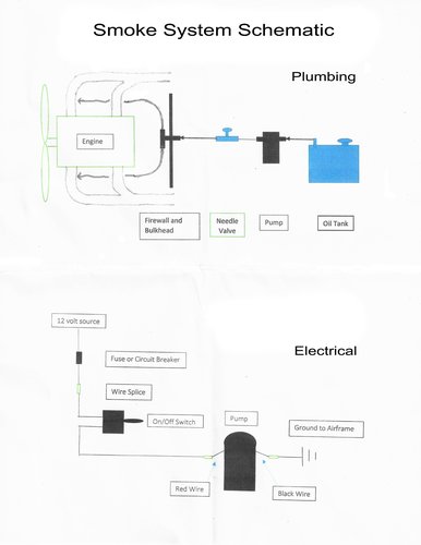

I got a smoke system up and running this weekend. Marvin was kind enough to provide a general schematic and design advice. Given that he only got to sell me $170 worth of parts and I sourced everything elsewhere - it was extraordinarily generous of him.
Schematic
Key points
  • Injectors must be as near the hottest point in the exhaust system as possible (JUST below the EGT probes).
  • The oil must spend the longest amount of time possible in the pipes to fully oxidize and reduce risk of fire. So on the AeroVee - the injectors go in the front pipes
  • A minimum volume of 1/2 Gall of oil a minute per 100hp is needed to get decent smoke volume.
  • If ordering Marvin’s injectors - be sure to ask for the “Rotax” injectors which are sized for the smaller AeroVee exhaust pipes.
Looking at complete systems - I was pretty sure that most of the pumps on offer were simply RV type fresh water pumps that the smoke system folks oversticker and reprice at aircraft pricing. My past life boatbuilding tells me these pumps use neoprene impellers or valves and can run dry, self prime and will pump just about any liquid. So I used a simple $30 Shur-Flo type that pumps 1 gall per min. Between losses from sucking oil from the tank and back pressure from pushing the oil into the injectors I just about got 1/2 gall per min (more about that in a moment).

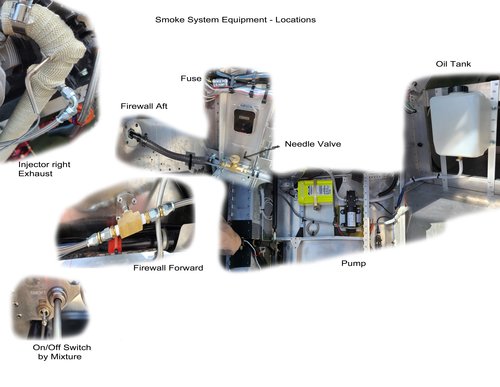

The actual equipment came in at 5lb total weight and consisted of:
  • 1 Gall “oil” header tank from Aircraft Spruce with a Venting Cap. As this is all positive G acro - no flop tube needed. Mounted on two aluminium straps in the back of the baggage compartment
  • Some reinforced hose
  • Pump which went under the seat pan with some wiring, in line fuse and a switch to activate. There are some fancy PTM/PTB switches and relays to be had that fit on your stick. But I just used a toggle switch next to the mixture control. As my hand is on the throttle for acro - it’s easy enough to extend a finger to flick the switch on and off as needed.
  • Needle valve to control pressure
  • Bulkhead fitting to get through the firewall
  • Aeroquip Stainless reinforced hose on the engine side to deliver the oil to the injectors on the pipes.
Equipment Locations in aircraft
For Weight and Balance - Smoke Oil comes in at about 7lb per US Gall.
