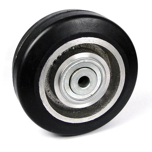

Sonex catalog suggest this replacement item:
Some time ago,I have purchased the same item from Aircraft Spruce:
But its quality is poor to me: the rim and “tire” were not turned to the correct thickness. It is flush with the hub which does not allow any installation within the original caster. And, the bearings are NOT sealed AND there is no lateral deflectors.
Has anyone any thoughts about this topic and some suggestion for a supplier for the Darcor tail-wheel, as per the original part?

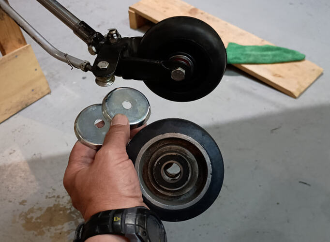

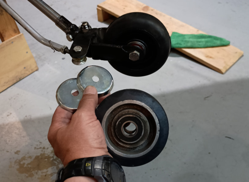

Hello,
I just received the Darcor W-64-XD 4" replacement wheels (same as delivered by Sonex in their kit back in 2005), a few minutes ago.
They weigh between 348 and 352 g.
As expected, the mass gain is about 35 % vs the ACS replacement part… remember, this at the most aft station of the aircraft.
Also, their quality is beyond comparison with competing products.
Tente/Darcor have done a great job with this purchase order.

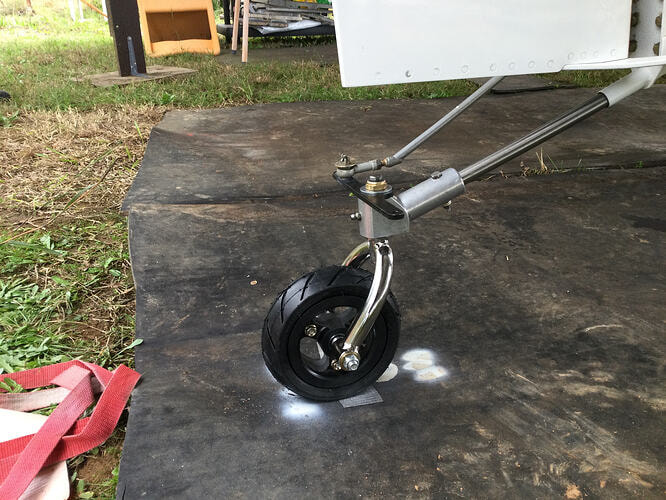

I am contemplating changing my API 4" tail wheel, to an API 6".
Depending on single fork or two fork configuration, the weight difference (from the 4") will be 0.06 kg (2.1 oz) & 0.15 kg (5.2 oz).
My Legacy is a tad nose heavy. I use up elevator/stick back in Cruise, when no weight in baggage area.
I know I should do the proper W&B calculations but just wondering what effect (if any) I will notice, with the two 6 " increases in weight, so far back & of course a smidgeon more drag? :smiling_face_with_horns:

I took Sosthène’s suggestion and ordered a couple of those wheels. I installed one tonight.
I left off the steel covers. It was 33g that I didn’t think I needed. Haven’t flown with it yet. That’s 0.25 lbs off the very back of the airplane.
150 x 50mm (6 x 2") pneumatic is sooo much better than the 4"
