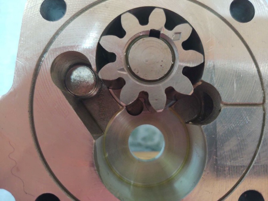

It appears that after talking to Kerry at Sonex, that one of the ports on the turbo side of my oil pump was never drilled out. He indicated that they saw one instance of this and thought it was a one off. Apparently not. I think their incident was on the input side of the pump. He sent me a picture and said to make sure the gears were visible through the hole and that the hole could just be drilled out if it wasn’t there. My problem appears to be on the output side of the pump. There is a dead end there. No path to the center of the pump. I’m waiting on a response from Kerry whether this side can be drilled out to the center of the pump. Does anybody here have a turbo pump that isn’t installed yet to see whether that hole is a straight shot to the center of the pump like the input side is? I tried to submit a picture of the interior of my pump but the board just hangs up and I can’t send a message. Probably a resolution issue with the picture.

I’d be interested to see what the incorrect vs. correct oil pump looks like if anyone has any pictures! I looked back through my photos of the engine build but I guess I didn’t really take any of the oil pump.

I’ll let you know Chris. The output port on my pump was not drilled through to the center of the pump. A problem from the supplier or shop that Sonex uses to modify the pump. The oil had no path to exit the pump and just came out the cover and backed up through the turbo. You can inspect your pump by taking the front cover off and making sure you can see the ports have been drilled through to the center where the gears are. Apparently the problem can be on input or output side. I’ll have to send you a pic of mine showing the error in an e-mail or PM. Kerry told me to just drill it out myself or it could probably be sent back for them to do it. I’m re-installing my turbo and hoping for the best. My runs were brief and RPM never got past 1500. Fingers crossed.

For everyone else’s reference, here’s Gregg’s picture by the way
