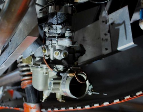

I have just changed from an Aerocarb to a Zenith in a standard tri gear Sonex and am now testing this installation. I changed nothing but the carb so I can swap back if the Aerccarb seems better. Has anyone else made the swap, and if so any words of wisdom. Since the airplane lives at 4700 msl, I can not check the low altitude performance, but I did have it up to 12,500 today and survived.

Re: Zenith Carb
Posted: Thu Mar 21, 2019 10:56 pm
by Jerry09w
The goal was to try the Zenith carb in such a way that I could easily go back to the Aerocarb. A short tube was welded to a carb flange that was the same size as the aerocarb spigot. The same AN fuel fitting was installed. The mixture cable was connected as the choke and the existing throttle was used. The only change to the airframe was a hole for a #10 screw in an engine mount gusset to mount a bracket to hold the outer shield of the throttle cable. So far the carb has just worked, It has been tested from my field elevation of 4700 to 12,500 so far with no problems. It seems to run correctly at full throttle and my max EGT spread has gone from 200 deg with the Aerocarb to 100 degrees with the Zenith. The CHT probe clamped to the input of the carb is to measure the input air temp, and one of the clamps on the output hose is an EGT probe used to monitor the temperature of the air after the carb. So far it has only been tested with an OAT between 40 and 60 degrees.
