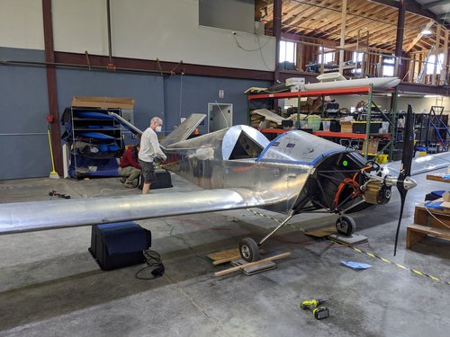

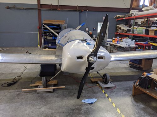

Hello Everyone! I didn’t want to post anything until I had made some substantial progress. Today I achieved the milestone of getting the new motor mount, motor, battery, and controller test fit to the front of my Xenos!
This is using an upgraded version of the Zero Motorcycles drive conversion I have on my Electric Ultralight, the E-Gull.
https://docs.google.com/document/d/1zLX … sp=sharing
I’ll be sharing more details as I go, let me know if you have any specific questions!

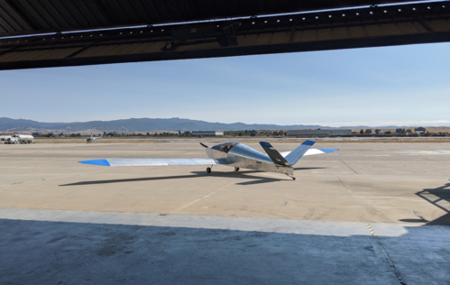

It’s alive!!!
http://www.youtube.com/watch?v=W_I5xnIPt9c
can’t figure out to how to imbed youtube video in here…

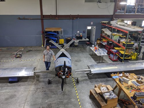

Have made some progress on the dash and wiring. Hoping to button that up this weekend! Then it’s onto canopy and cowling. Then final assembly! I have some friends helping over the next week or two for physical and emotional support to get me over the hump :slight_smile: I am hoping she’s ready for inspection in something like a month!
Last week did an initial weight and balance and trial fit of the wings. They don’t go on that easy…
All up, ready to fly is about 800lbs. And CG actually came out just about as perfect as it could be. Just about dead center in the cg-range with a light pilot, and near the rear with 400lbs of people in the seats. Even with the super overbuilt motor mount and heavy battery, it’s basically a perfect 1-1 swap. Amazing…

Lonnie did reach out to me but I wanted to get some “baseline” testing with this prop before trying anything else.
Canopy 90% complete. Final assembly (I hope) begins tomorrow with wings going on.

It flies! 40 minutes, 40 miles, 40% battery remaining. Lots of testing, tweaking, and improvements to go. With a planned battery upgrade, duration will be about 1.5 hours and range will be 100 miles!
Videos uploading on my youtube now…
