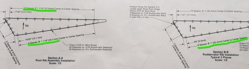

For those of you working on the tail kit please note that the metric call out on the page listed above and highlighted below is listed incorrectly, it should be 27mm but is called out as 25.4 which is closer to 1 in instead of 1 and 1/16. I sent an email to the factory but I already built on ruddervator wrong hoping to not have to change it or to just have to add one rivet to it but its already closed out =/

Got the OK from the factory in case anyone made the same error.
