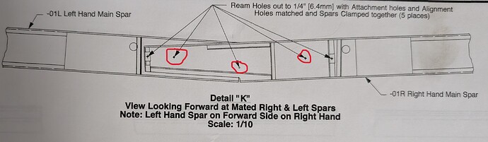

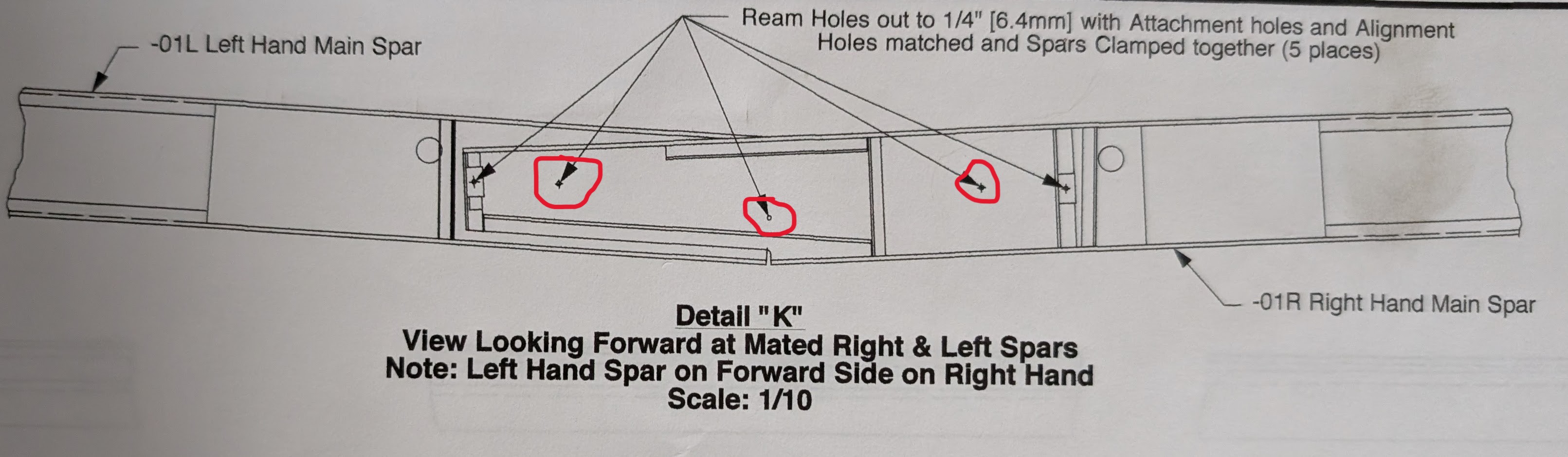

I have a question regarding wing pins, the previous builder along with the big main pins and the secondary pins decided to drill three 1/4” holes evenly spaced two outer ones are towards the bottom and middle one is towards the top. They had bolts with nylocknuts on them and were a pain in the butt to take out. My question is,what impact do the holes have on the spars? Would the extra bolts make them to ridged? Fill with jbweld? Start a separate topic?
Greg
A picture would help. There are no secondary pins. Ultimately this may be a question for Sonex tech support. JB Weld - no way.
Hi Greg,
I just want to confirm, are you talking about the alignment holes depicted below? Or different holes?
There’s a reason why you don’t put bolts in the alignment holes. They are just 1/4” holes, and the material thickness is not very much. The amount of movement the wing structure likely sees as you approach limit load will likely cause damage around those holes. The bolts are really strong, but look at the structure where the main pins go. There is a lot of bearing area between the 3/8” bolt and the aluminum. The 3 holes that Evan circled above won’t have much meat and for high loading the stresses on the aluminum spar will be really high.
