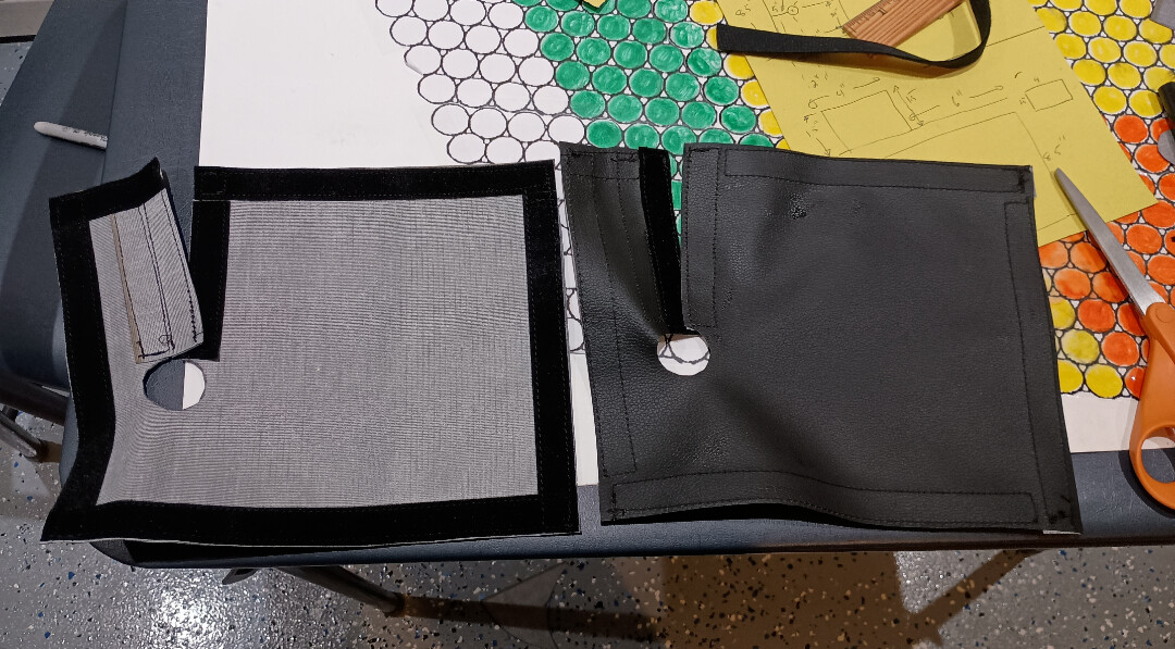

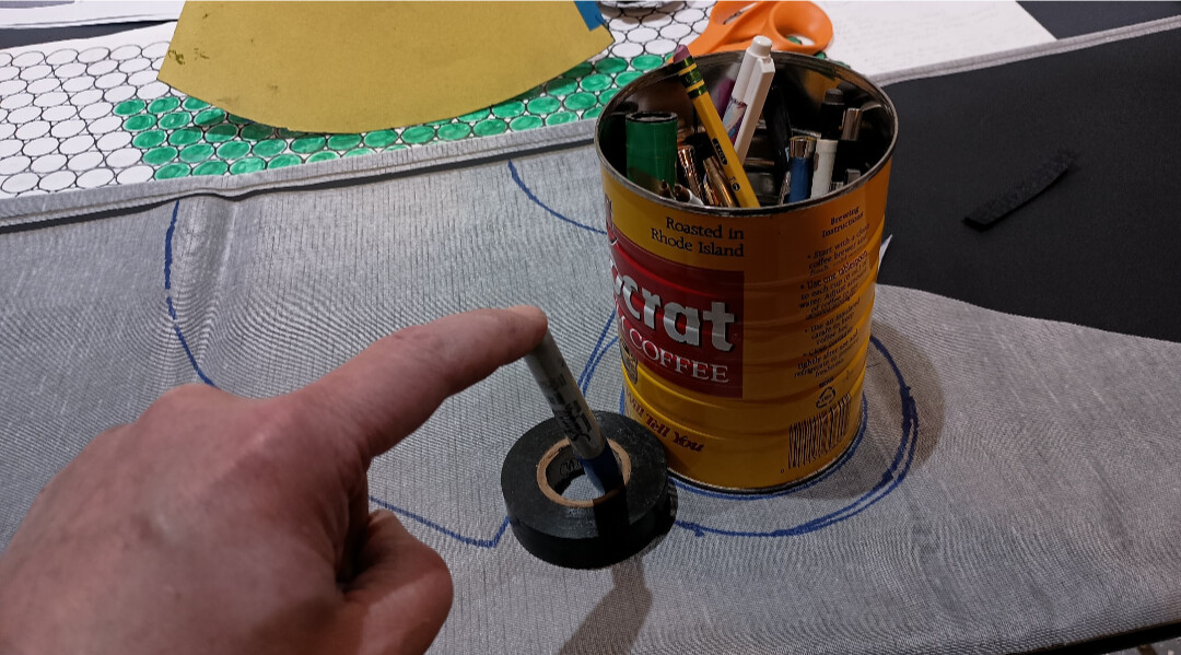

Getting heat in my Waiex was a real benefit for the arctic climate of northern Illinois and Wisconsin. But there is still a lot of cold air pouring in through the wing roots. Like a few others before me, I’ve decided to block off the penetrations of the aileron pushrods and the flap torque tube. Ailerons first. I made a paper pattern, and for the base I used a coffee can for the inside of the circle and I used a roll of electrical tape to mark about a 3/4” flange width.

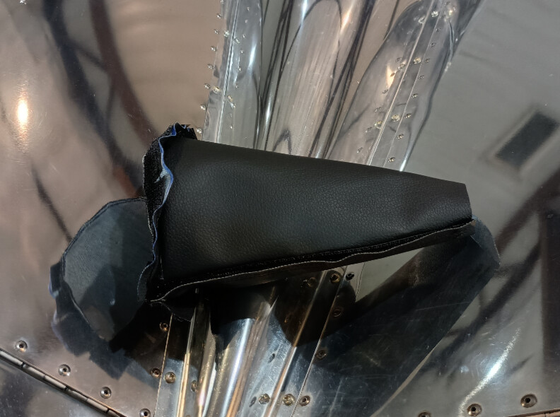

I sewed opposing velcro on either side of the conical section so I could close it up into a cone. The ring that I cut out from the trace above gets velcro sewn onto it, then it is sewn to the bottom of the boot.
Here’s what it looks like closed up.

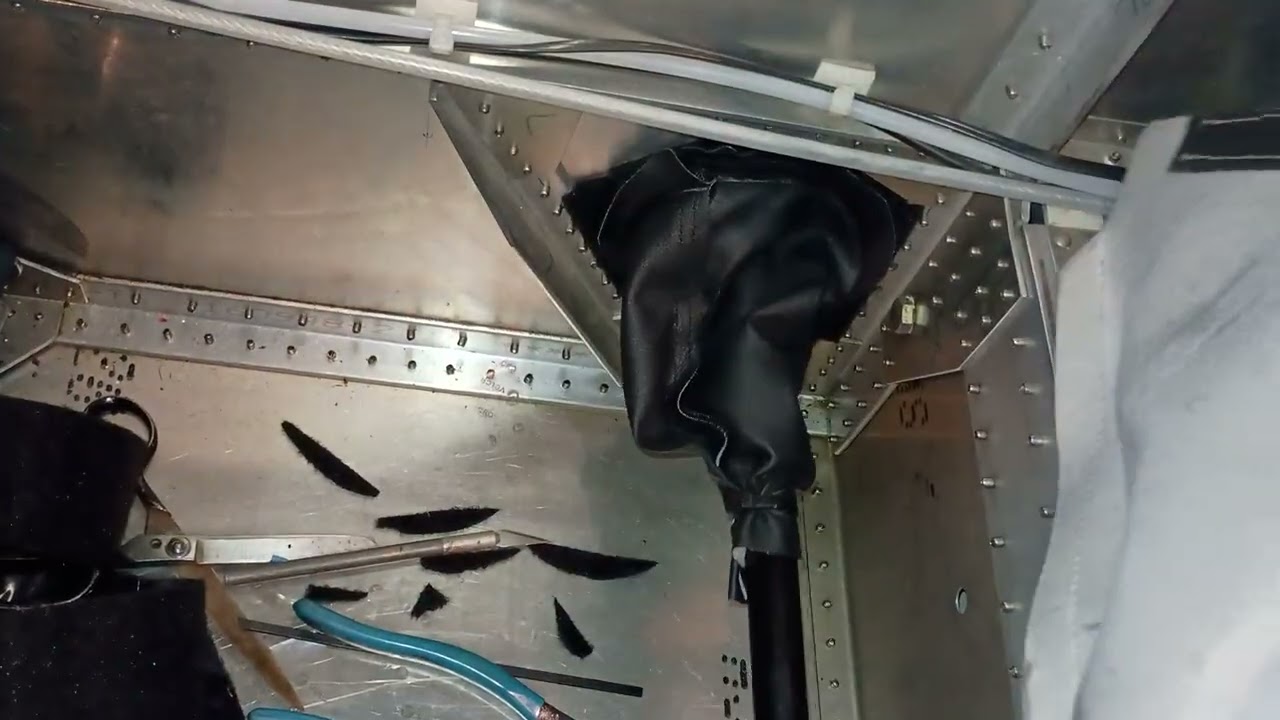

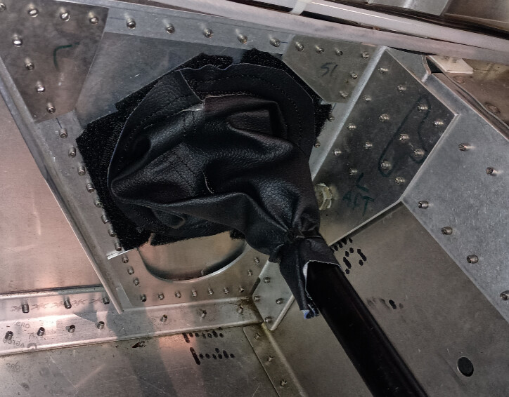

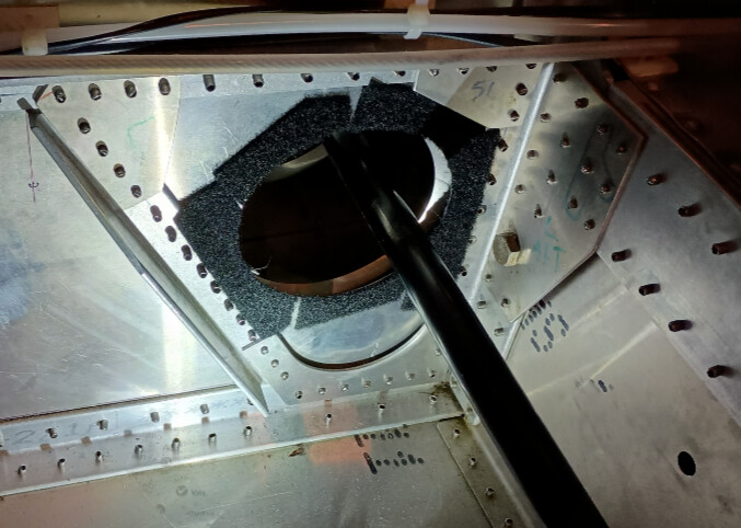

I cleaned off around the perimeter of the 4” hole in the fuselage with acetone, then used the heat gun to warm up the aluminum to stick velcro to it. I trimmed the inside of the hole with an exacto knife.
Next the boot gets close over the tube, and velcroed to the fuselage. I used a zip tie up near the top to seal it up good.
It’s not the most beautiful piece of work ever, but the judges at Oshkosh are unlikely to see it. I used some really thin vinyl from Amazon - looked through the reviews and found one where a few people complained about it being thin. I thought thin would be better in this application than the heavy duty marine vinyl I used for the seats.

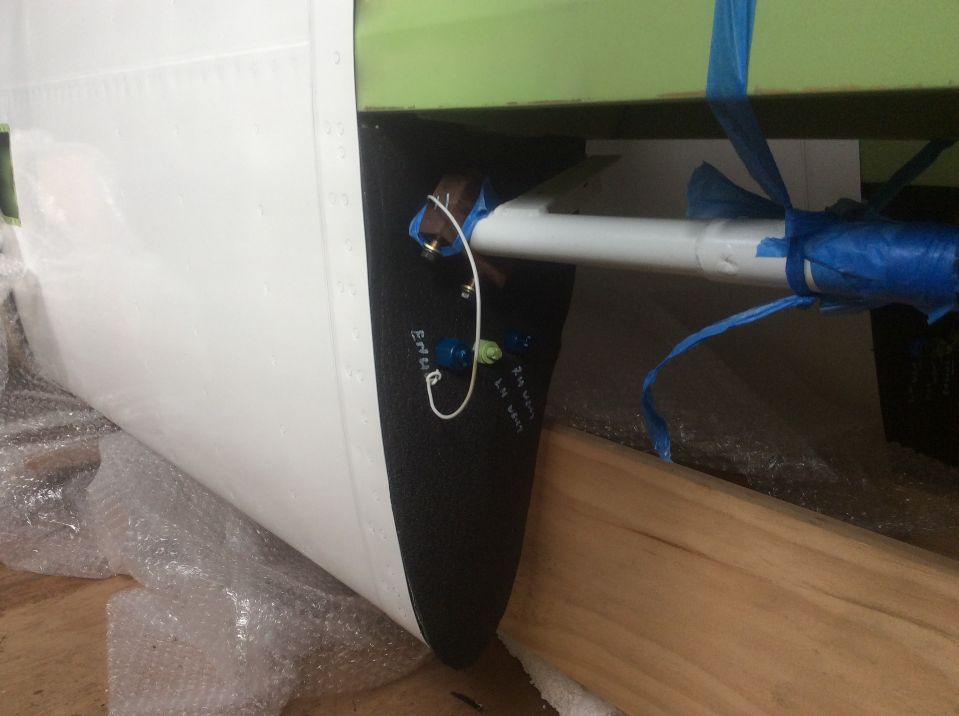

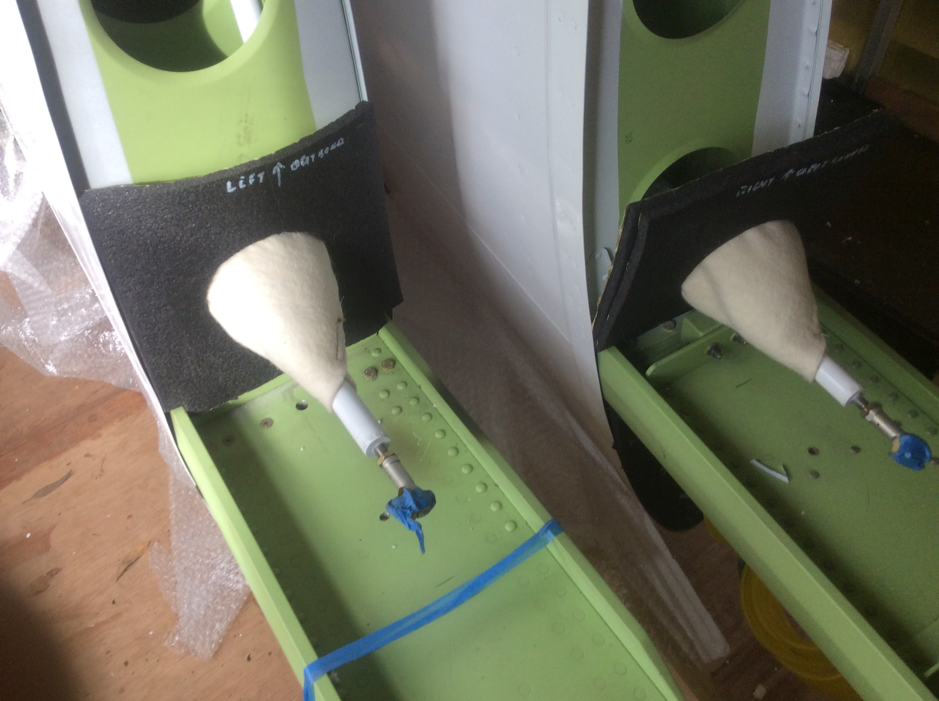

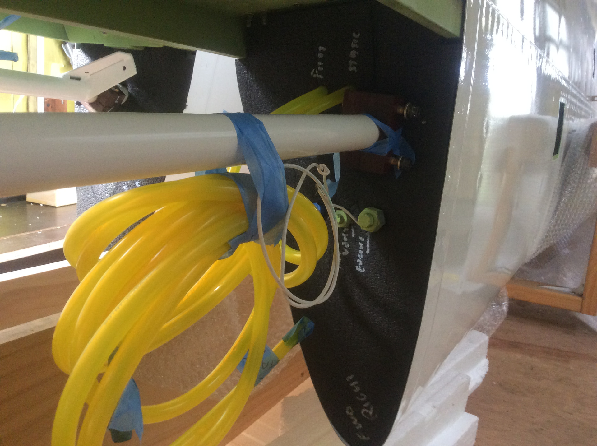

I have used a combination of shaped 10mm tick foam sheet in the wing roots , pure wool felt “witches hat” on the aileron rods and air-conditioning aluminium tape on the wing spar box holes, to achieve a draft free cockpit . Works a treat. :smiling_face_with_horns:

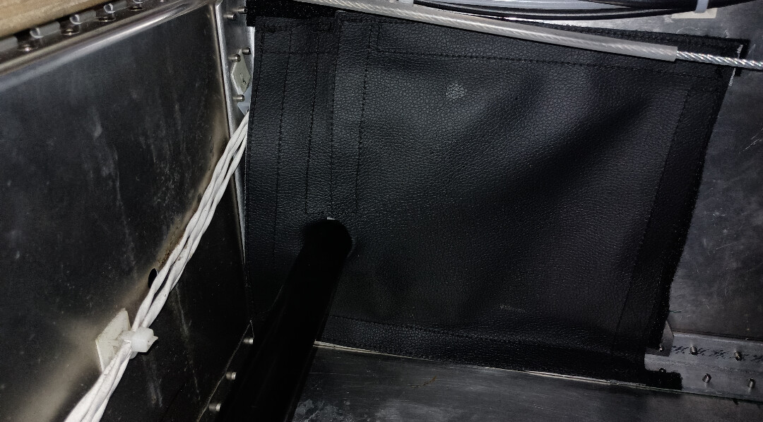

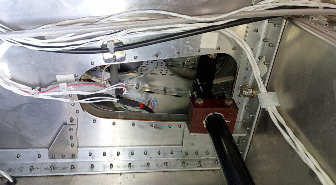

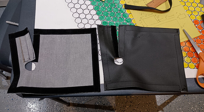

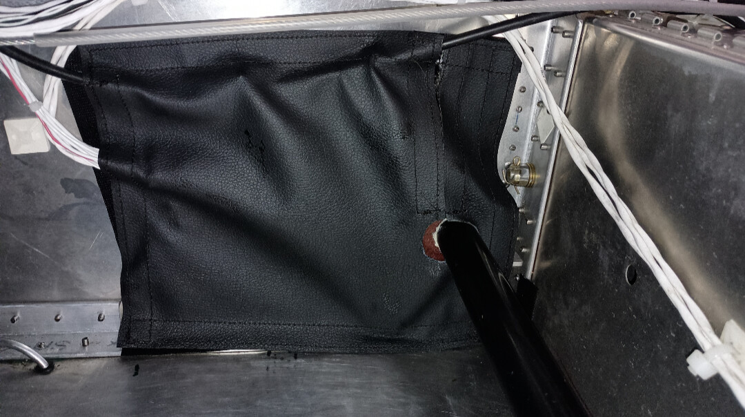

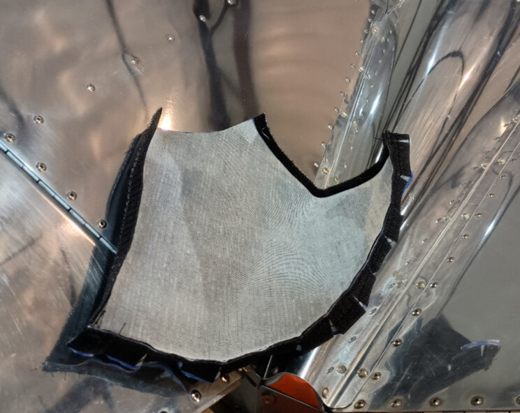

Here’s what I’ve made for the flap torque tube penetration. Just sewed these, heading over to try fitting them.

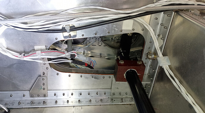

Before:
After:
The wool felt slides on the aieron rod. In the unlikly event of it snagging/catching on the rod, the witches hat will concerteener.
Note: One wing root is slightly deeper than the other. For a snug fit you may have to double the thickness of the foam (black) as shown in photo.
If you are wondering what all the plumbing fittings are - My Sonex has 30L x 2 wing tanks, so supply & breather lines , plus level sensor wiring.
The yellow hose is Pitot/Static & A of A :smiling_face_with_horns:
Here is the other side. Airplane is buttoned up and ready for a test flight tomorrow. Overnight low is forecast as -7 F, and the high is going to be 8F.
Note to other nutjobs who fly in the cold, it would have been a lot easier if I did this before wiring and riveting the floor on.

Easier & neater to do it before fitting the wings, as I did. :smiling_face_with_horns:
