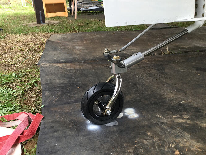

New Peter Anson “Hota” 150-50 mm tail wheel fitted. Looks great! Taxi/flight testing will have to wait for weather to improve. New set up 0.213 Kg heavier than 4". Great service from Peter Anson. :smiling_face_with_horns:
Hi skippy,
Looks good! where did u get the tail wheel bracket?
full swivel?
michael.
I am the registered builder/finisher of my Legacy however the starter and main builder, from plans, was the person responsible for the tail wheel as a whole.
I understand he purchased a complete tail wheel from API (https://apitailwheels.com/) but was unhappy with the resulting angle - two custom made brackets/ head stocks later, he was satisfied with the angle - this is the bracket I am using. Aside from the angle, its an exact copy of the API system. It has a full 360 degree caster, very useful for parking. :smiling_face_with_horns:
Hi Skippy,
Thanks for the info. Yes flyboy accessories made some sonex brackets but they used the vans required angle about 21 degrees,
blake was going to make some new sonex sockets set at 30 degrees, but the vendor unexpectedly died. peter anson uses 28 degrees. The flyboy sockets could be made to work if you cut the socket with an angle grinder, bend it to 28-30 degrees, and weld it shut.
And yes differential braking required for full swivel tailwheel.
michael.
