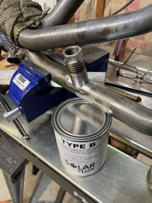

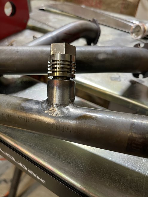

I’m installing an O2 sensor on cylinder 1 because the 3 to 1 exhaust is leaky, and I don’t want incorrect AFR readings:

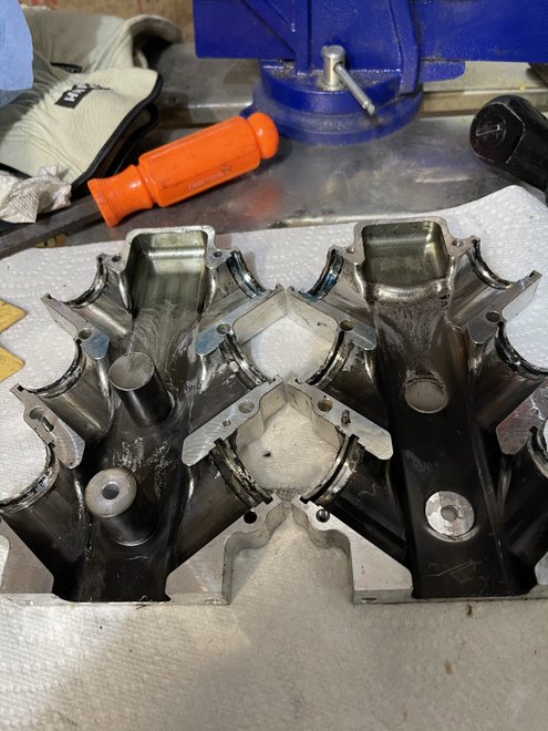

I wondered what the inside of the intake manifold looked like. I was surprised at how black the rear of the manifold was, and wow, that is some serious obstruction in an effort to get even mixture to the cylinders:
