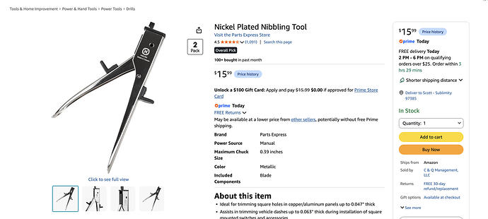

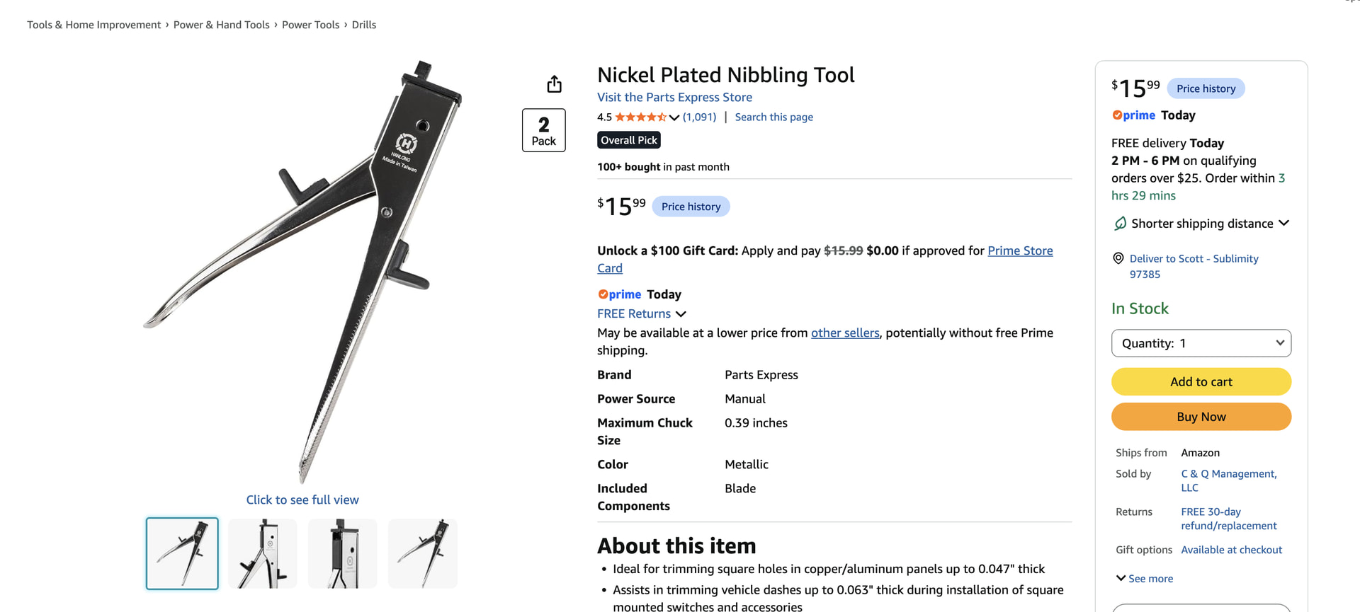

Get yourself one of these for small close work. Supper easy to use and you will love them later on the panel for cutting square holes.

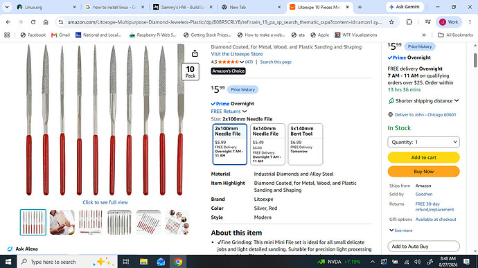

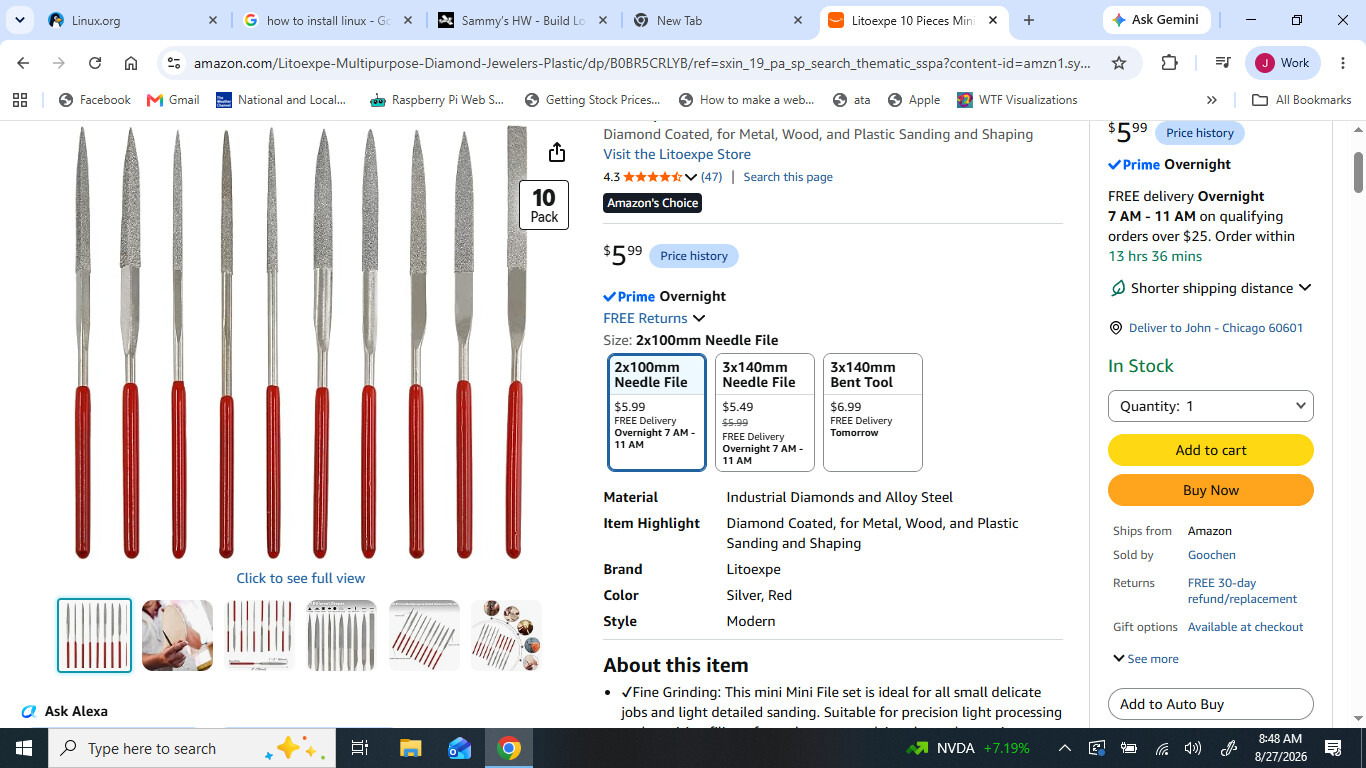

I used a small round needle file to put in a radius if I miscut the hole for the radius or had to move an edge. Pressing it in the direction parallel to the one you’d like to keep can get you a new radius. I used these: https://www.harborfreight.com/12-piece-precision-needle-file-set-4614.html
My favorite needle file is half round, half flat.
When cutting sheet metal, I always wear a good pair of gloves for protection. I have gone to the Dr. twice for infected slivers. I prefer the yelllow dear skin gloves. Over time, they shrink to fit your hand. If OJ had been wearing dear skin gloves, he would have been found guilty. I also have a set of small files for fine work like this.
My 1/4 round bastard file has teeth on the edges. My mill file doesn’t. My small mill file has teeth on one edge. If your not watching closely, they will make hash out of your 1/8 inch hole.
Bastard files cut on both the push and the draw, mill files cut only on the push. The tiny files use bort (low grade industrial diamonds) as an abrasive, and is nondirectional in it’s cut. Bastard files are used to remove material, Mill files for finishing.
