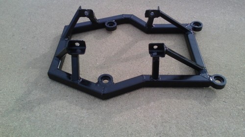

If anyone is still interested in a mount to fit up a 912 to a standard aerovee mount I have just finished a prototype and it is a good fit under the universal cowl . it does however place the prop hub forward of where the aerovee sits by 15 mm this being unavoidable .This mount replaces the original rotax ring mount and bolts directly to the standard shock rubbers on the aerovee mount thus eliminating the need to modify anything. Any interest let me know
Regards Bish sonex 1178

Hi guys
Took me a while to post these so please remember this was the prototype so a wee bit rough but still a nice fit
Regards Bish

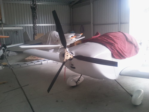

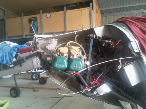

Posted: Tue Dec 13, 2016 11:16 pm
by garyb
Rotax progress.

Very nice! What size/type of tubing did you use? Did you move the Rotax forward at all due to it being lighter? Do you have weight and balance calculations for the Rotax position?
Re: Rotax Engine Mount?
Posted: Wed Dec 14, 2016 2:40 pm
by garyb
gcm52 wrote:Very nice! What size/type of tubing did you use? Did you move the Rotax forward at all due to it being lighter? Do you have weight and balance calculations for the Rotax position?
Same tubing as the Sonex plans suggest, the hub is 1/4 inch further forward.
