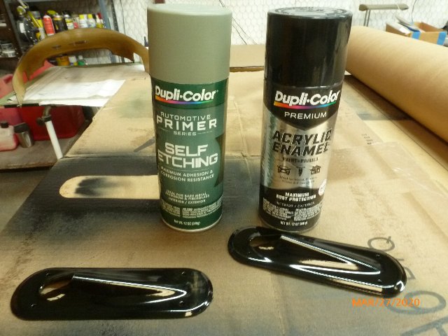

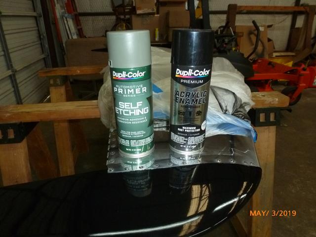

I tried several different paints while building Onex #89 and finally found some primer and paint that worked every time and on all surfaces. I was looking through some old pics and came across this.
Also, I walked into an FBO and saw a can of this exact primer sitting on a work bench. Highly recommended.
My weapon of choice:

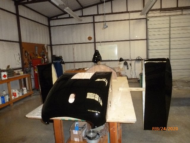

My paint is not that great. Compared to some of the zillion $ paint jobs out there it’s probably an embarrassment. But, if I have a scratch, or modify my fiberglass parts, I can just scuff the surface and squirt on some more. It’s awesome.
I would never try to paint an entire aircraft with rattle can. All of the fiberglass on my aircraft, except the tail tips, was painted with Alexseal. I didn’t want to destroy my shop, so I rolled it on. There are videos on the internet that show how it’s done. It’s an easy way to have a two-part paint job without spraying or having it sprayed.

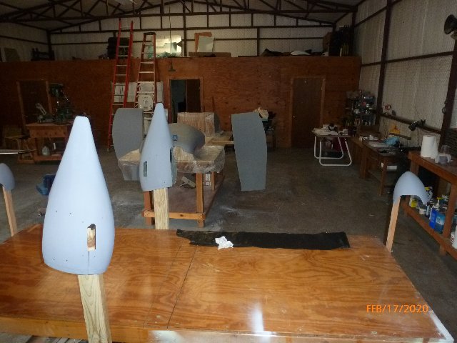

The Paint Garden:

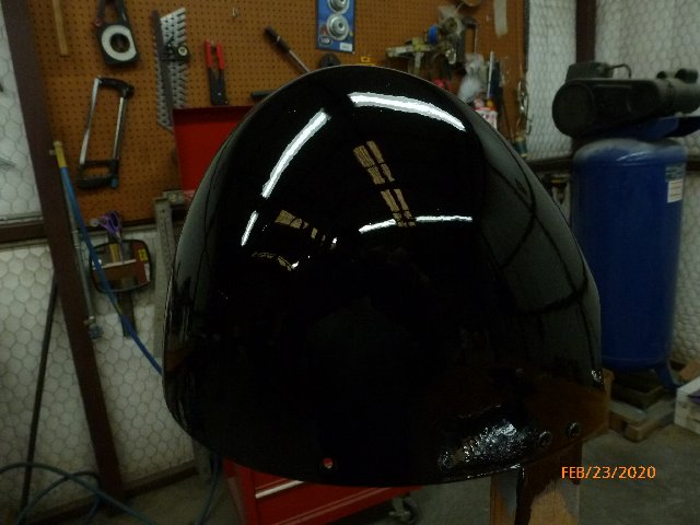

Nice and shiny:
Rattle Can on Tail Tips:
