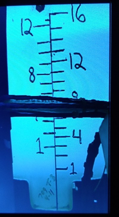

karmarepair wrote:I think a sight gauge is a manageable risk, for situations where Ethanol containing MoGas is the desired fuel.
Or, a fuel camera:
Here is mine:
16 gallons.jpg (75.6 KiB) Viewed 1408 times

No joke! I just stole somebody’s good idea and it works. I poured in 1 gallon at a time, and marked the tank for both the 3 point and level attitude. There is a short strip of LED lights taped to the underside of the tank.
If I was comfortable with clear fuel line in the cockpit, I would have gone with the sight tube. But I really wasn’t.
