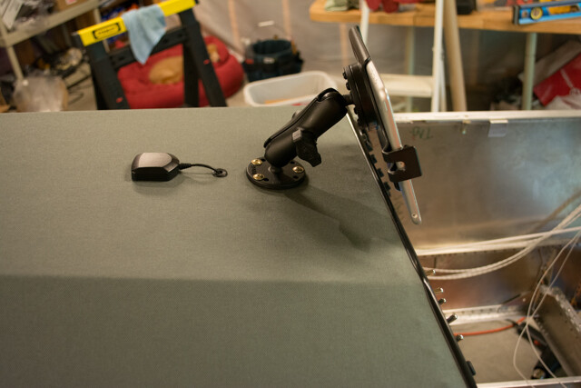

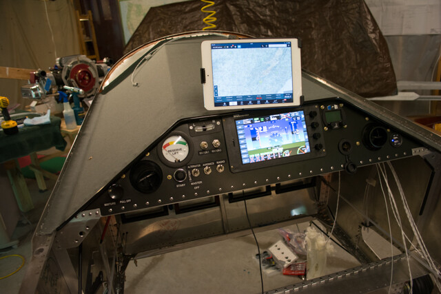

I second the Ram mount system, they are well built and solid. With a ball base, arm and Ipad mount you can mount an ipad pretty much anywhere you want in the cockpit. I put mine on the glareshield.
Wherever you have room to mount the base (which is fairly small) you can then position the ipad wherever you want it to be.
As you can see in the pictures mine is in the middle but I’m tall and don’t have an issue seeing past it. You could mount it on the glare-shield closer to the front edge and have it hang past and in front of the instrument panel. I did add a .032 2"x2" backing plate (held in place by the mounting bolts) under the glare-shield to stiffen it up a bit.

Like your panel a lot, love the simplicity, including the vent balls in the panel. Can you send me some more pictures of you panel and cockpit to gvrsmurray@gmail.com. Much appreciated.
