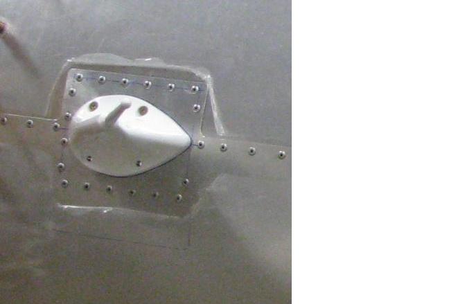

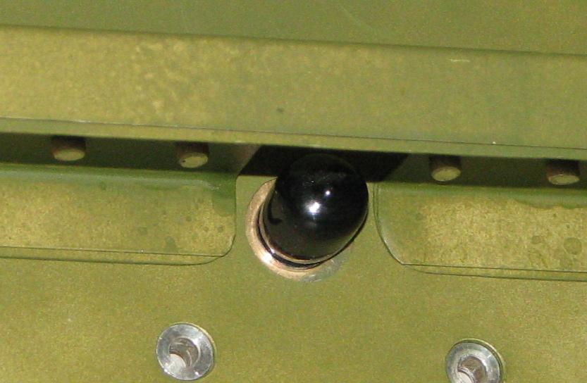

Posted: Tue Aug 09, 2011 2:14 pm
by Rick524
Just an update on the antenna mounting. I have the turtledeck all riveted together complete with my overlapping tabs. It turned out the tabs only needed to be 3" each, which left me with a 6" square area for the antenna. The antenna ALMOST sits flat on the turtledeck. It came with a thin foam gasket that will fill the small gaps on the sides nicely.
Rick
Sonex 524
Turtledeck on it’s side with comm ant mounted.
Inside view of re-inforced C channel under antenna.
