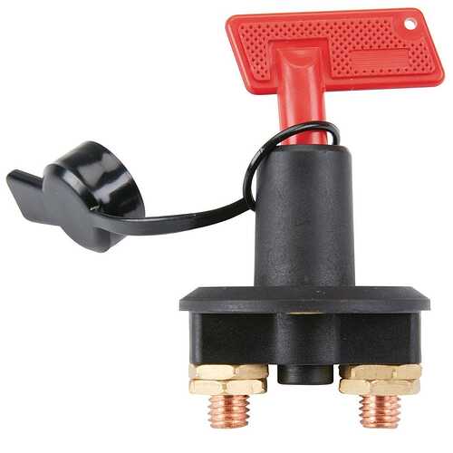

I’m re-posting one of my favorite ideas. Instead of a conventional electric master contactor, I’m using a mechanical one. This one in particular:

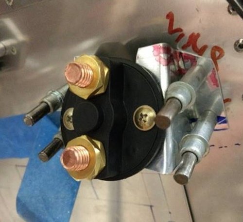

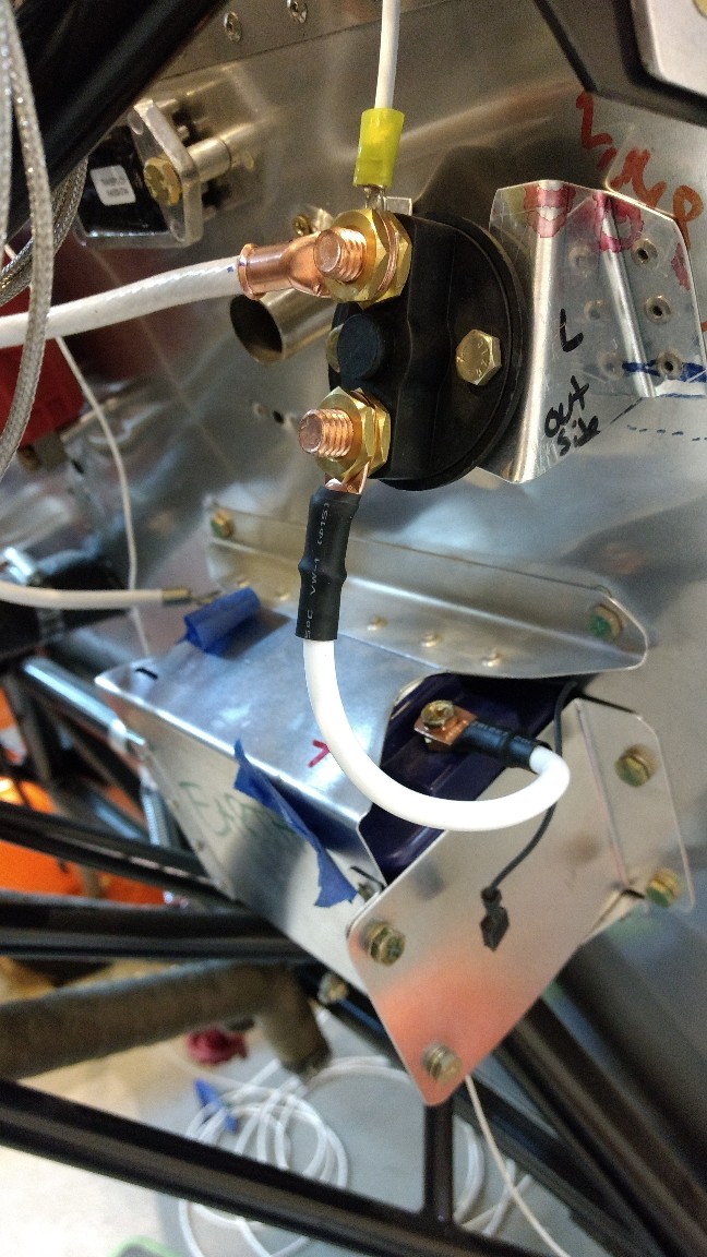

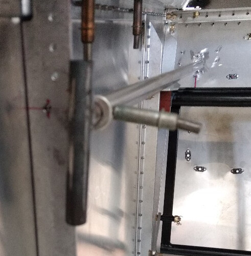

It mounts forward of the firewall, using some angled standoff brackets.

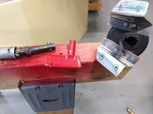

The plastic key gets discarded. I made a steel key, and also sacrificed a 1/4" u-joint from the tool collection. This key gets riveted to an aluminum torque tube.
This is the off position.
It’s a 90 degree turn to on.

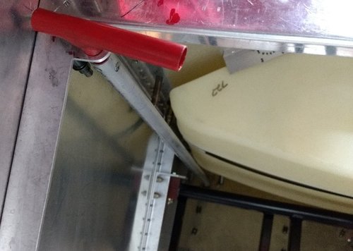

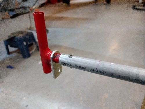

In the cockpit, I’ve painted the handle red and labeled it. That little bracket screws onto the angle forward of the wing spar tunnel. It’s a loose fit.

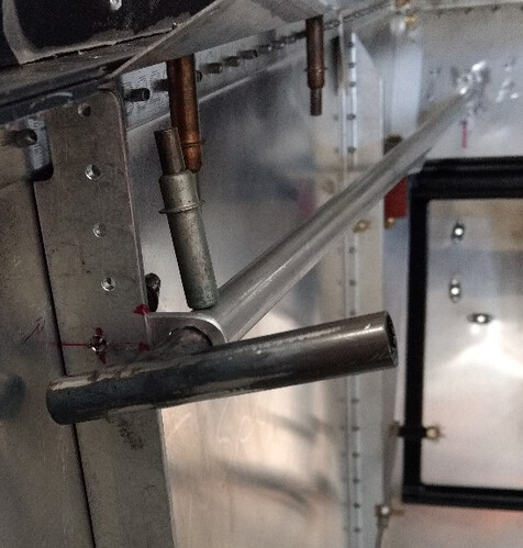

Here is how it gets past the tank.
In the old thread, it was mentioned that the conventional master contactor weighs about 13 oz. When I weighed all the parts it was about 2 oz less.

Another picture
