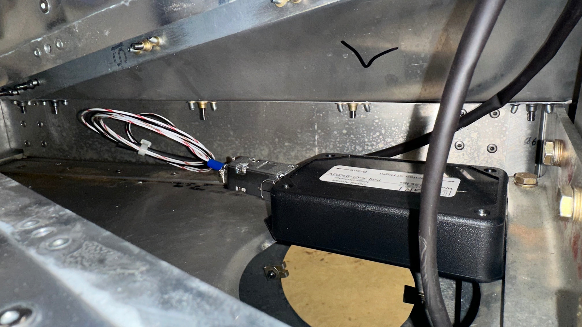

I have a magnetometer for my GRT mini and mounted it in the tail section. There is a nice little platform right in front of the spar for the horizontal
stabilizer that is easy to access from the two removable covers that we all complain about making.
