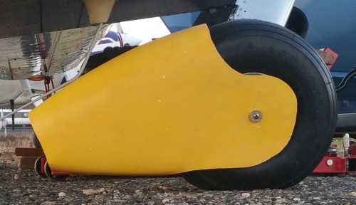

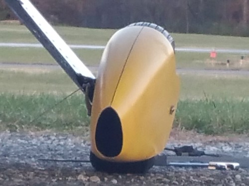

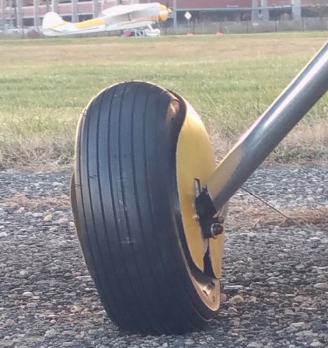

  1. Maule-like wheelpants. These permit larger main tires without adding drag or weight. They were constructed from the stock wheelpants. (I had been getting stuck in softer soil.)
