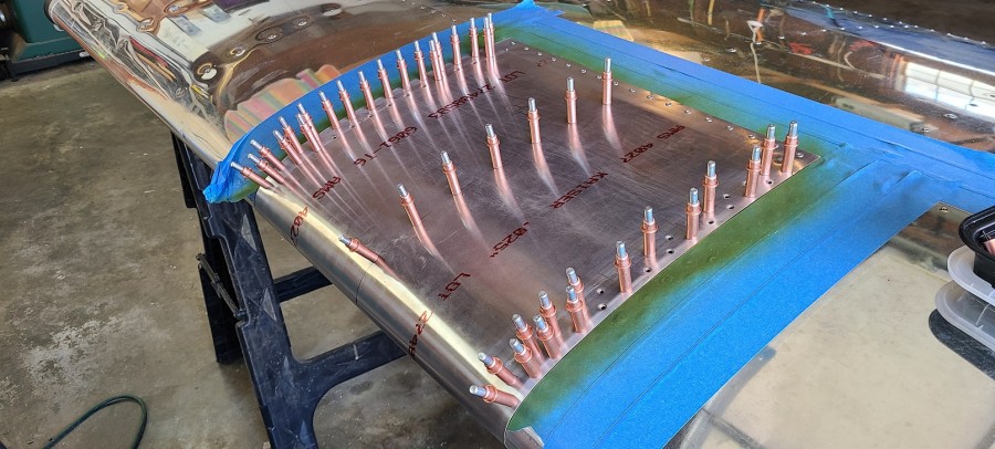

In late April 2021 I ordered a bunch of CCC-44 rivets from Aircraft Spruce. I was performing a repair in the wing leading edge skin using the methodology for a “Stressed Skin Repair” outlined in AC_43.13-1B which calls for a doubler plate and staggered rows of 1" rivets.
With the job all drilled, deburred, dimpled, Scotchbrighted and Primed - I clecoed the whole thing back together to start riveting. Lots of extra Cleco’s around the tight nose bend.
The “outside” of the job holding the doubler plate is done and rivetted. It’s under the blue tape.
I carefully riveted the job so that every second hole was filled between the Clecos. With the job all now held by the in-between rivets - Clecos out and fill in the rivets where the Clecos had been.
At which point things did not go well. The in-between rivets were not pulling correctly. It had gone fine when I was applying the doubler plate to the outside of the hole. But filling in with the patch - Rivet mandrels were breaking deep below the surface of the rivet. With the mandrel not pulled up to the surface - I had doubts about the shear strength of the job - which comes from the rivet being filled with mandrel. Test drilling out of these rivets confirmed they were not firmly squeezed - too many just immediately “spun” on the drill tip.

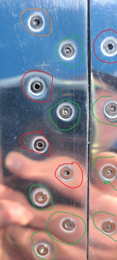

Then I realized that the second pass with the “in-between” rivets had been from a different bag of rivets. Spruce had provided the order in two batches which came from different warehouses. Just to confirm my suspicions - I set the job up on some scrap and watched the hidden side of the rivet to see what was happening. No matter how perfectly square I was pulling the rivets at exactly the same pull pressure with the electric riveter - the back of the rivets were not deforming evenly. I mean they never do pull perfectly evenly - but these were curling over significantly to one side and the mandrel would then fail deep inside.
Red are bad. Green are good or acceptable. The differences in this picture are completely caused by the batch of rivet used.
Contacted Spruce. I don’t blame them for being a little skeptical. I had used all the “good to me” rivets in my first passes - so I was struggling to get a comparison on my test job. They had me measure the “bad” rivets to confirm they had sent the correct thing in the labelled bag. They had. They wanted details of the job, thicknesses being riveted together, methodology, tools used, pressures used. They then sent me replacement rivets from a batch that was different than the “bad” rivets. I also got an RMA to send back the remaining bad rivets.
I set up the same test with scrap and tried the new rivets with the same electric riveter and pressure. Rivets pulled evenly with almost no curl and broke off correctly at the surface. Transferred job to the repair on the plane and the rivets all pulled correctly. (So I wasn’t crazy). Sent Spruce pictures of how much better the replacement rivets had worked.
